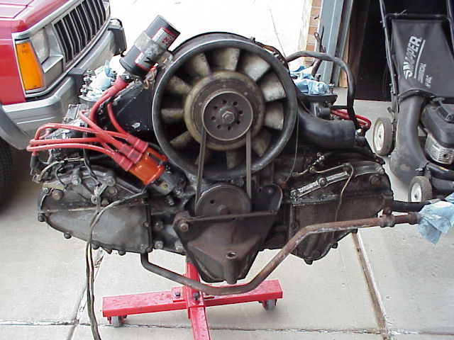

Got the engine on the stand today. 2 liters (2.2? Nobody knows for sure) and 6 cylinders of screamin Porsche power. I'm addicted to the sound. Can't wait to hear it again.

Gint   The $60 ebay engine stand bracket set I bough...   Apr 19 2003, 10:51 PM

Lawrence914-6   Mike, Nice engine stand. eBay special? One time...   Apr 27 2003, 11:37 AM
