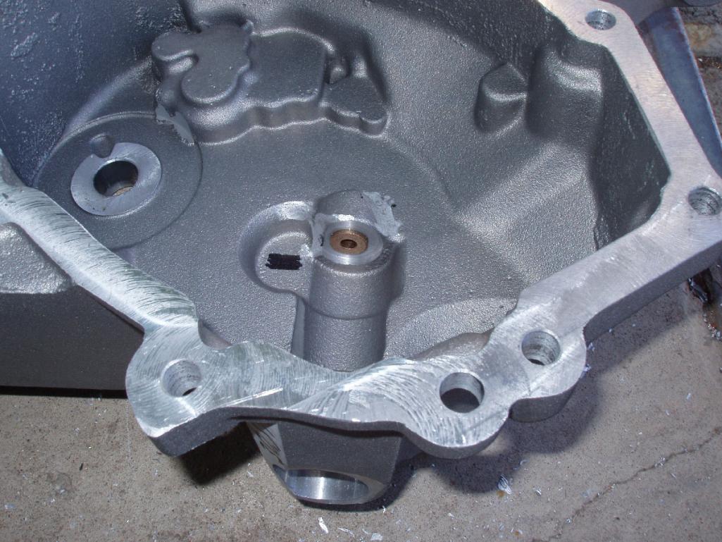

Had some days time to do work beside the industry-orders on the CNC Mill. Put the nosecones on the mill again yesterday and milled the place for the speedo drive. Pressed bushing inside and tested speedo drive (as far as I could - shaft is not turned or not finally turned). Works fine, just as on the prototype. The shaft of the small speedo drive will be turned within the next few days, then the 916 kit will be available with mechnical speedo finally. A further argument for the 916 kit.
Martin

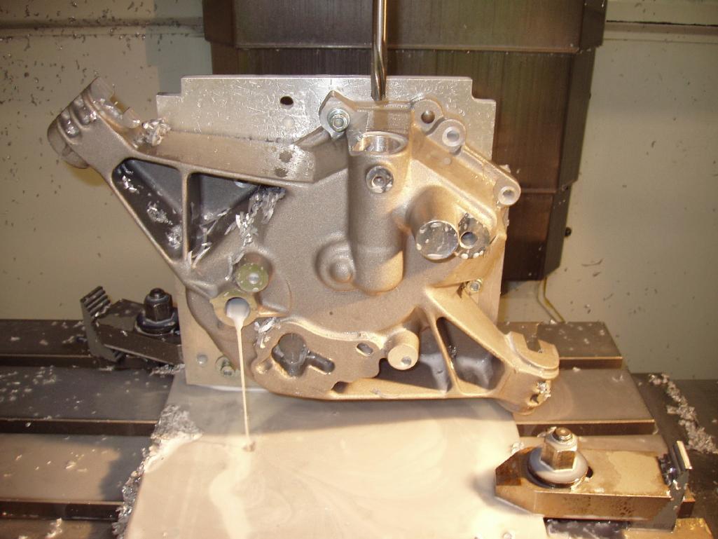

bugat5speed   23.2.2010: pictures of the milled shift housings. ...   Feb 23 2010, 02:09 AM
bugat5speed   picture from the other side:   Feb 23 2010, 02:12 AM

bugat5speed   Hi, could do the housings first. Will start the ex...   Feb 24 2010, 01:12 PM
bugat5speed   another picture:   Feb 24 2010, 01:14 PM
