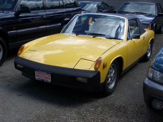

Looking at my first 914 purchase, may look at a '76 model (see link)...any pro-cons to the '76 models?
Thanks

MarkG   914 potential purchase   May 27 2004, 09:01 AM
skline   Pros: 76 was the first year Porsche started using ...   May 27 2004, 09:07 AM
skline   Oh, one more Pro, being as the 76 was the last yea...   May 27 2004, 09:10 AM
James Adams     May 27 2004, 09:27 AM
seanery   I agree, my 76 was a rusty hulk. If you want a go...   May 27 2004, 09:35 AM
Jeroen   The '76 galvanizing was only on the 911s (and ...   May 27 2004, 09:43 AM
brant   Yeah, I gotta agree.. teeners weren't galvani...   May 27 2004, 09:53 AM
Gint   Welcome to 914club MarkG! Are you on our loca...   May 27 2004, 09:55 AM
ninefourteener   Looks like it may be sagging a bit in the rear.......   May 27 2004, 10:03 AM
tat2dphreak   7K sounds steep, but if it's rust free(mostly)...   May 27 2004, 10:07 AM
Gint   Actually Mark, if you want, I can shoot over there...   May 27 2004, 10:13 AM
MarkG   thanks Gint...no need though; I talked to the deal...   May 27 2004, 10:40 AM
seanery   I'm sure you know this but, spending a little ...   May 27 2004, 10:45 AM
Gint   I may go look at it tomorrow anyway if they still ...   May 27 2004, 10:49 AM
MarkG   Sounds good Gint! And Seanery, you are 100% ...   May 27 2004, 01:22 PM
Gint   Pretty nice car. Very nice paint. Didn't see...   May 28 2004, 10:18 PM
Gint   nother   May 28 2004, 10:19 PM
Gint   front   May 28 2004, 10:21 PM
Gint   Jck posts on both sides look like they've been...   May 28 2004, 10:23 PM
Gint   Probably the worst of the rust on the entire car. ...   May 28 2004, 10:24 PM
Gint   Forgot the pic...   May 28 2004, 10:25 PM
Gint   Full rear trunk view...   May 28 2004, 10:26 PM
Gint   Interior is faded, but very presentable. I never ...   May 28 2004, 10:27 PM
Gint   I guess the pic would help wouldn't it...   May 28 2004, 10:29 PM
Gint   It's too bad this shot looks like on of Andy...   May 28 2004, 10:30 PM
Gint   Dammit   May 28 2004, 10:31 PM
Gint   It was hard to see the hell hole, but what I could...   May 28 2004, 10:33 PM
Bleyseng   Looks like a real solid car! Geoff :D :trophy...   May 29 2004, 08:34 AM
Gint   Maybe not. The dealer salesman told me they did s...   May 30 2004, 07:49 AM
mikester   It's also got pedrinis on it - unless it...   May 30 2004, 08:34 AM
tod914   Those rims where made for both early and late styl...   May 30 2004, 09:06 AM
neo914-6
  May 30 2004, 09:24 AM
MarkG   Dang, I might just have to trek up to Boulder this...   Jun 1 2004, 02:55 PM
Ferg   I did see that car prior to the body work, there w...   Jun 1 2004, 03:02 PM
seanery   take a magnet   Jun 1 2004, 03:15 PM
MarkG   Sounds like a pass, may still go up Saturday, if n...   Jun 1 2004, 10:45 PM
