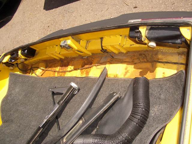

Gint   Pretty nice car. Very nice paint. Didn't see...   May 28 2004, 10:18 PM
Gint   nother   May 28 2004, 10:19 PM
Gint   front   May 28 2004, 10:21 PM
Gint   Jck posts on both sides look like they've been...   May 28 2004, 10:23 PM
Gint   Probably the worst of the rust on the entire car. ...   May 28 2004, 10:24 PM
Gint   Forgot the pic...   May 28 2004, 10:25 PM
Gint   Full rear trunk view...   May 28 2004, 10:26 PM
Gint   Interior is faded, but very presentable. I never ...   May 28 2004, 10:27 PM
Gint   I guess the pic would help wouldn't it...   May 28 2004, 10:29 PM
Gint   It's too bad this shot looks like on of Andy...   May 28 2004, 10:30 PM
Gint   Dammit   May 28 2004, 10:31 PM
Gint   It was hard to see the hell hole, but what I could...   May 28 2004, 10:33 PM
