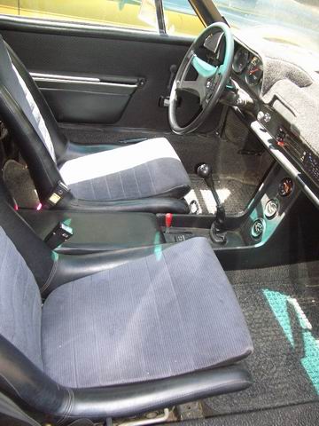

Gint   Interior is faded, but very presentable. I never ...   May 28 2004, 10:27 PM
