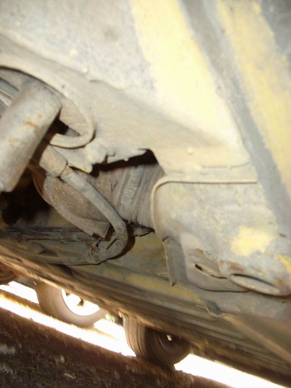

Gint   Pretty nice car. Very nice paint. Didn't see...   May 28 2004, 10:18 PM

Gint   Jck posts on both sides look like they've been...   May 28 2004, 10:23 PM
Gint   Probably the worst of the rust on the entire car. ...   May 28 2004, 10:24 PM

Gint   It was hard to see the hell hole, but what I could...   May 28 2004, 10:33 PM

Ferg   I did see that car prior to the body work, there w...   Jun 1 2004, 03:02 PM
seanery   take a magnet   Jun 1 2004, 03:15 PM
MarkG   Sounds like a pass, may still go up Saturday, if n...   Jun 1 2004, 10:45 PM
