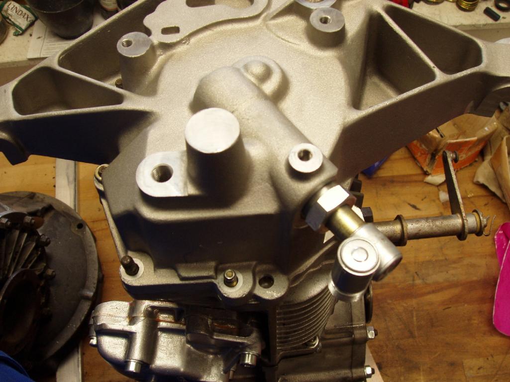

@ Steve: thanks for the infos! I will use an older 915 for my car, as I´m gonna use the 2.2 E engine (MFI) - S-configuration is the aim. If you go 2.7 or bigger it´s anyway better to have the 8:31 combination. In that case I would prefer the aluminium cased 915 although more weight - but also more stabile (just as you did).
@ all: picture shows gearbox with mounted speedo drive. Nuts of nosecone still missing. Have to install the reverse gear switch actuator still. Bolt to fix the speedo has to be turned cause left the socket too high for the original 914 screw. Next batch of nosecones will be milled down there.
