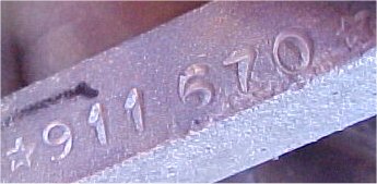

engine# 911 670
he says it's a 225hp 3.0...Brad? others?
what displacment case is this?

meursault   No WAY is that engine a 3.0. That case is an early...   May 31 2004, 11:55 PM

seanery   early aluminum cases are desirable, and if that on...   Jun 1 2004, 07:52 AM
