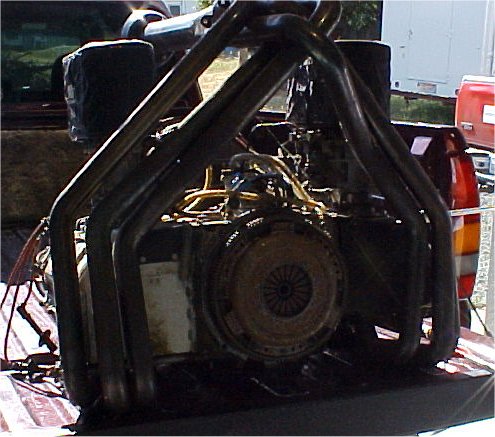

I have a line on a 911 engine with Webers in the 245hp range for, say...$1500. (IMG:style_emoticons/default/cool_shades.gif)
I don't have any of the details on displacement, CR, builder, age, blah, blah...yet.
Of course, you buy it. (IMG:style_emoticons/default/chowtime.gif)
Question is, What will I pay to finish the install?
After exhaust, fuel set-up, adapters,oil tank,etc...Bottom line is?
$2000...$3000...$5000...tell me straight up, I'm sitting down! (IMG:style_emoticons/default/rocking nana.gif)
What are the positives and negatives of doing this? (IMG:style_emoticons/default/confused24.gif)

Bought the motor...I think congratulations are in order! (IMG:style_emoticons/default/cool_shades.gif)
First, we checked the cylinders for leakdown with a air testing device. 4 were great, 1 good, 1 a little blow-by. This was done dry and cold so we are pretty sure after valve adjust, running the motor and running oil through it, letting it loosen up a bit, it should be O.K.
The plan: get it running next week on the bench.
I'd like to put the six in my car basically as is. Just get it running well.
If I can get 130-140hp that should keep me happy.
Labor will be a fair work trade for a bathroom remodel. I can do a lot of the mechanical work myself.
I'm going to clean the six tomorrow ala McMark style to get a quick fix. (IMG:style_emoticons/default/wink.gif)
If all goes well, I'd like to see the car in full dressed six by winter (IMG:style_emoticons/default/beer.gif)

trekkor   O.K. Sorry to be a carrot dangler. I have the app...   May 31 2004, 07:19 PM
trekkor   Guys...Really..What would you do?   May 31 2004, 09:08 PM
trekkor   MMMM :chow:   May 31 2004, 09:09 PM
trekkor   Webers   May 31 2004, 09:10 PM
trekkor   engine# 911 670 he says it's a 225hp 3.0...Br...   May 31 2004, 09:12 PM
trekkor   The price really is $1500.00 He doesn't ...   May 31 2004, 09:15 PM

meursault   No WAY is that engine a 3.0. That case is an early...   May 31 2004, 11:55 PM

trekkor   Thanks for all the feedback thus far. :clap: I...   Jun 1 2004, 04:47 PM

trekkor   Bought the motor...I think congratulations are in ...   Jun 1 2004, 10:29 PM
