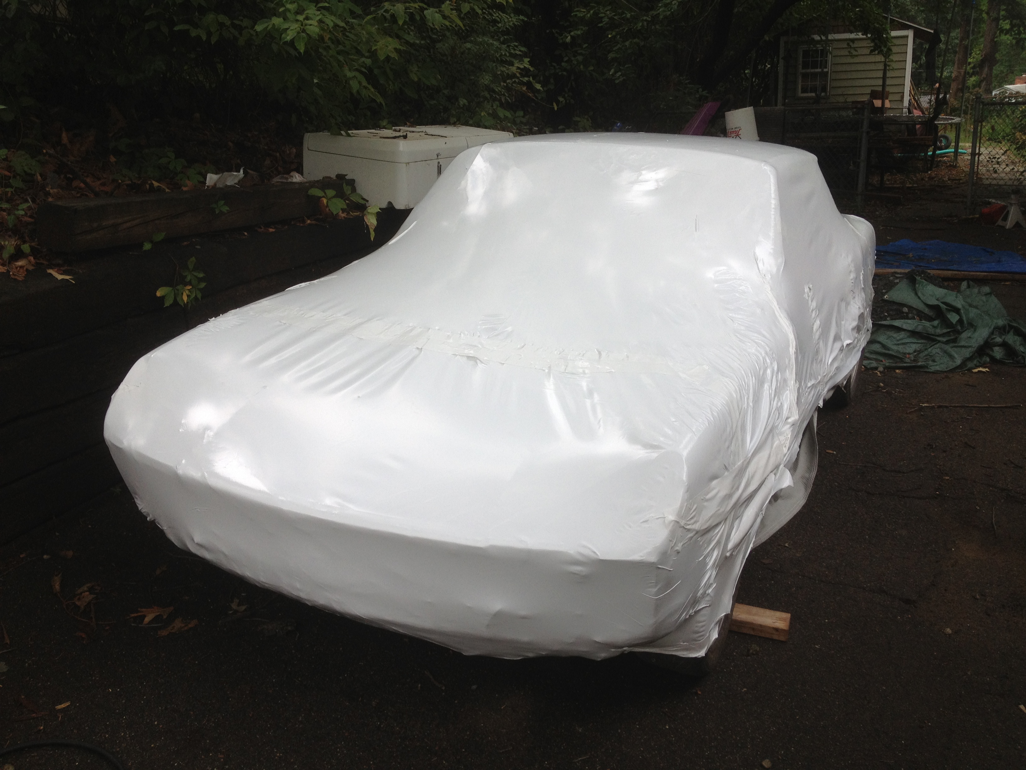

OU8AVW   Built a Garage.... We use this shrink wrap stuff t...   Dec 22 2012, 03:22 PM
scotty b   Makes a nice love shack too :miles:   Dec 22 2012, 03:40 PM
Dasnowman   Makes a nice love shack too :miles: Scotty wh...   Dec 23 2012, 02:00 AM
scotty b   Makes a nice love shack too :miles: Scotty w...   Dec 23 2012, 07:27 AM
