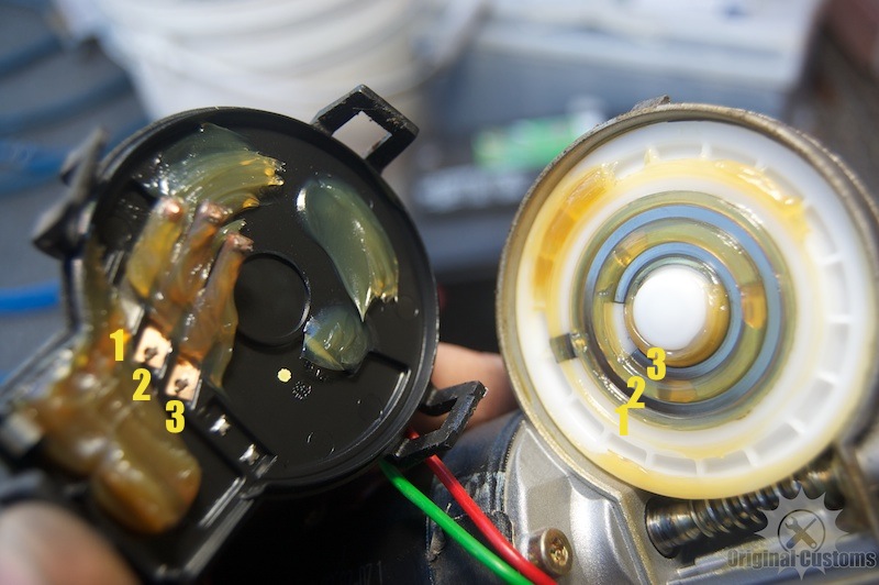

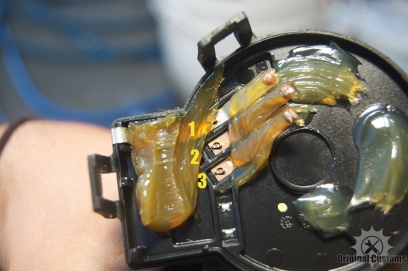

Here's a couple shots with the cover off. I noticed an important piece of info I missed the first time. Connection #1 is also grounded to the motor body full time. The implication is that those 'park' connections shouldn't be run as 12v switched. The need to be a ground connection off of a relay. Which makes sense.
One note that may not be obvious because of the grease. The metallic portion set into the white plastic is one solid piece of metal.

McMark   Here's a couple shots with the cover off. I n...   Jul 22 2012, 11:10 AM
kg6dxn   Great photos! I can really see all the dirt an...   Jul 22 2012, 11:38 AM
McMark   Stock 914 wiper motor looks exactly the same on th...   Jul 22 2012, 01:30 PM
