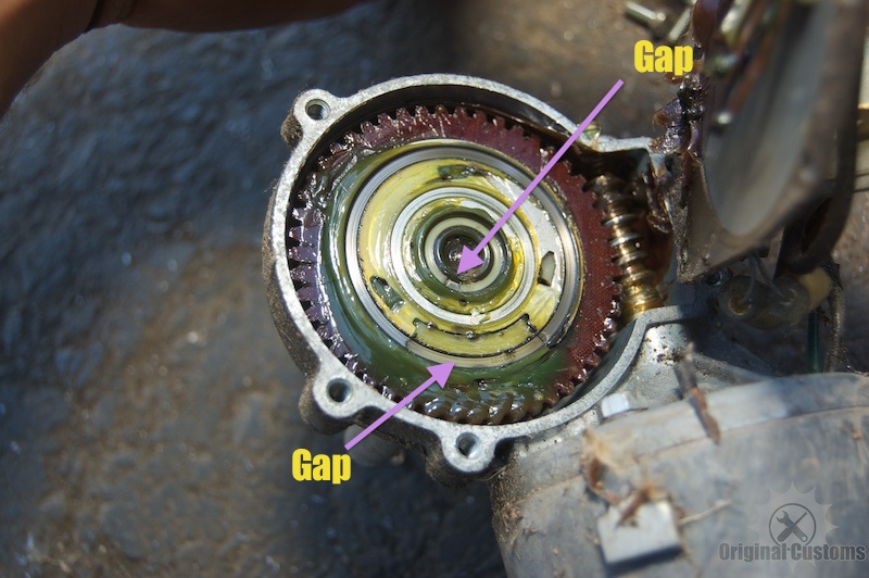

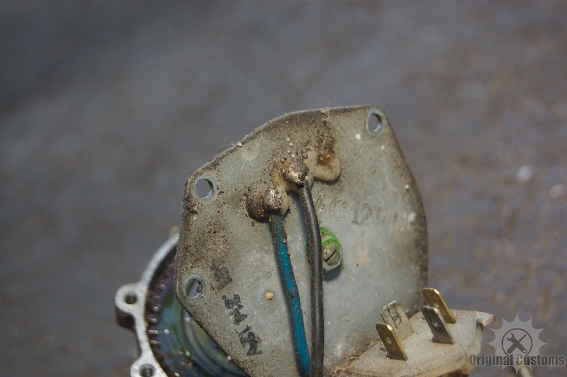

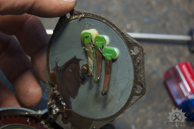

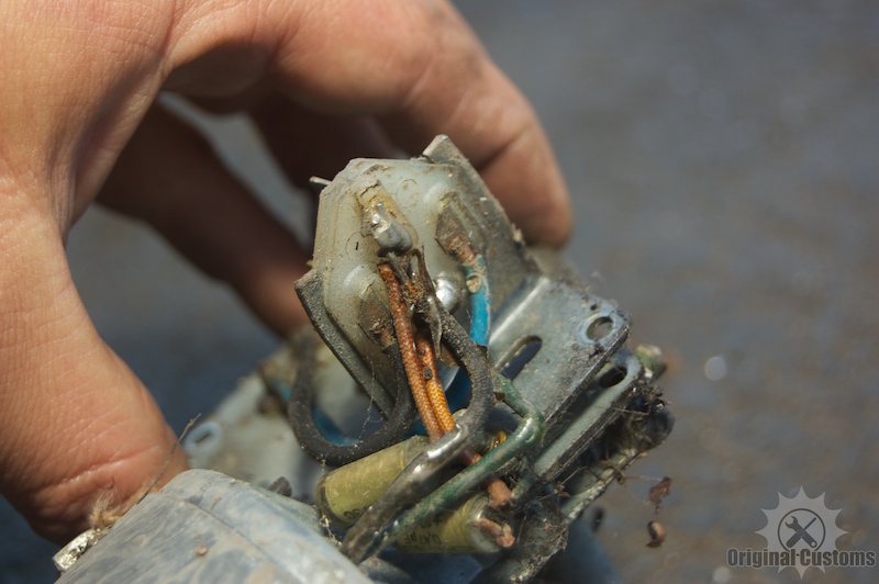

Stock 914 wiper motor looks exactly the same on the inside. That means it'll get wired up just like original. This'll be pretty easy.

McMark   Here's a couple shots with the cover off. I n...   Jul 22 2012, 11:10 AM
kg6dxn   Great photos! I can really see all the dirt an...   Jul 22 2012, 11:38 AM
McMark   Stock 914 wiper motor looks exactly the same on th...   Jul 22 2012, 01:30 PM
