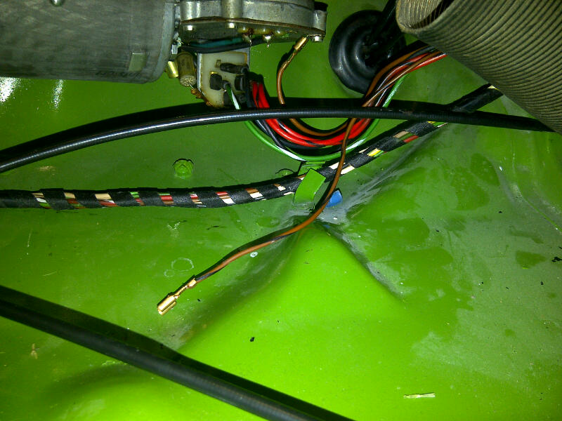

Here's an image from Kansas_914's build showing the wiring.
(IMG:http://www.914world.com/bbs2/uploads/post-373-1310215620.jpg)
To translate:
Boxster Motor ----> 914 wiring
red ----> black/purple
green ----> black/blue
1 ----> empty/no wire
2 ----> green/white
3 ----> red/black
(IMG:http://www.914world.com/bbs2/uploads/post-419-1342976166.jpg)
This wiring isn't confirmed - just based on research. Use at your own risk. (IMG:style_emoticons/default/shades.gif)
