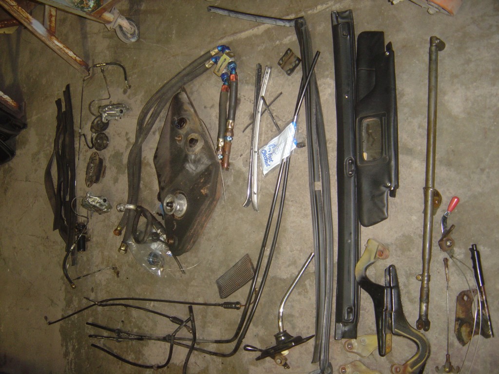

In the beginning there was......
Attached Image Attached Image Attached Image Attached Image Attached Image Attached Image Attached Image Attached Image Attached Image Attached Image Attached Image Attached Image Attached Image Attached Image Attached Image Attached Image Attached Image Attached Image Attached Image

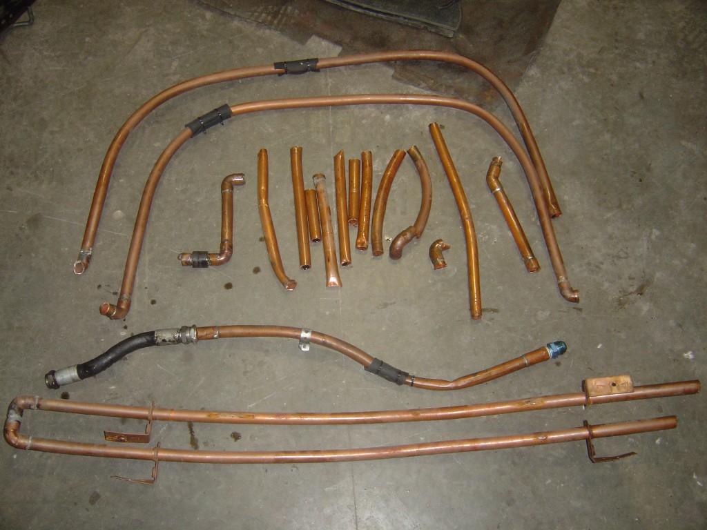

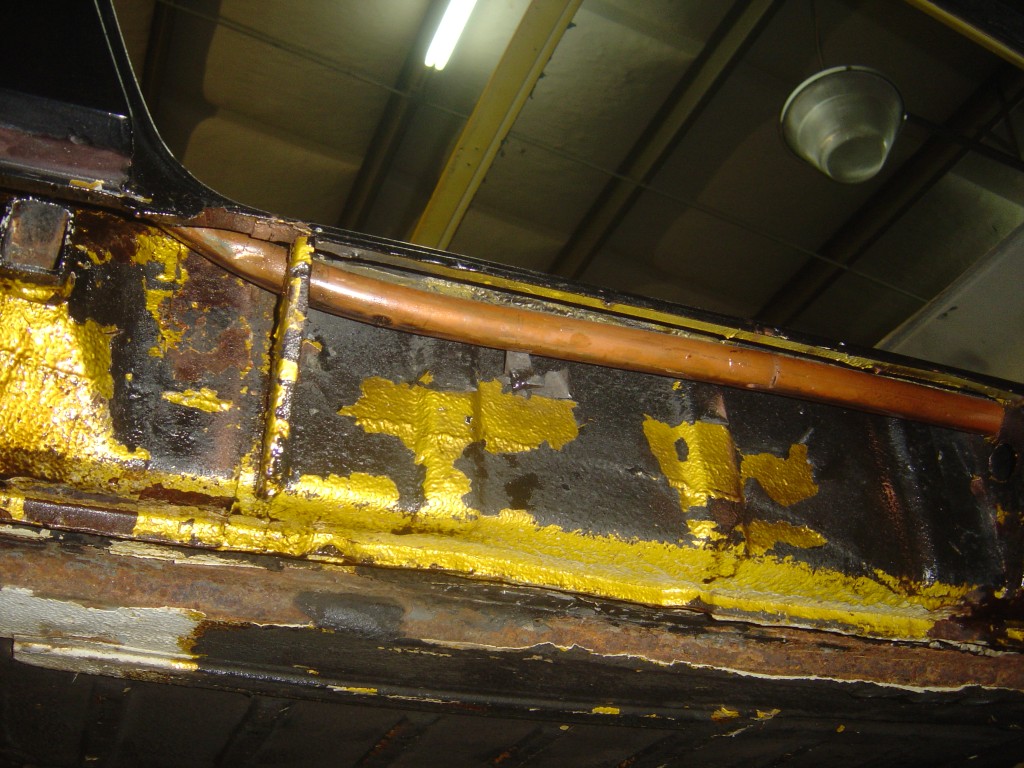

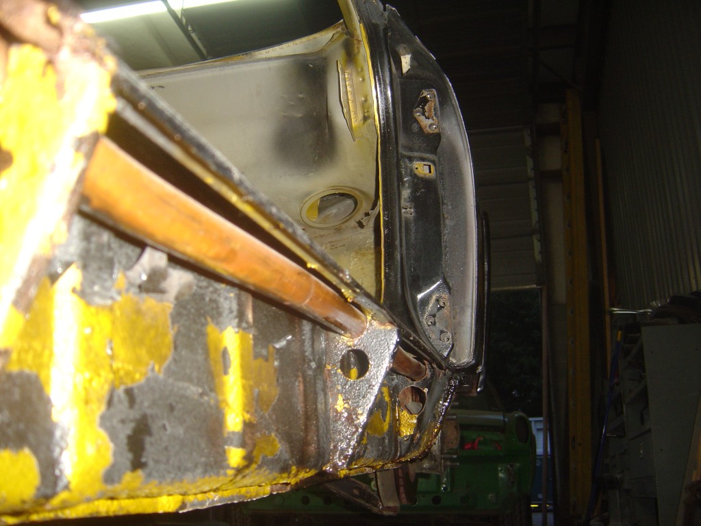

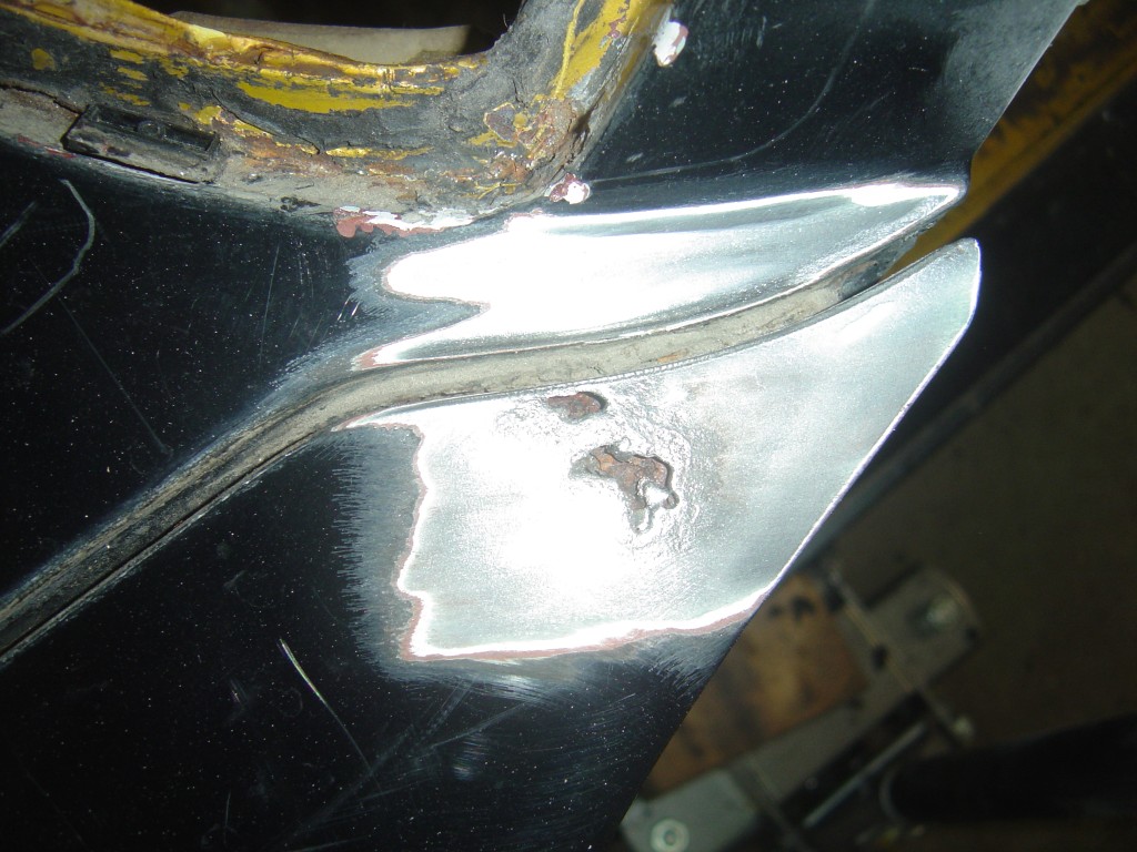

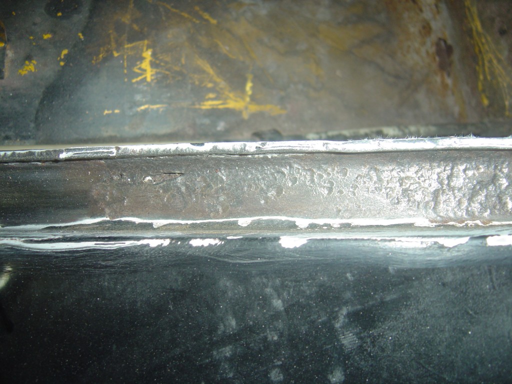

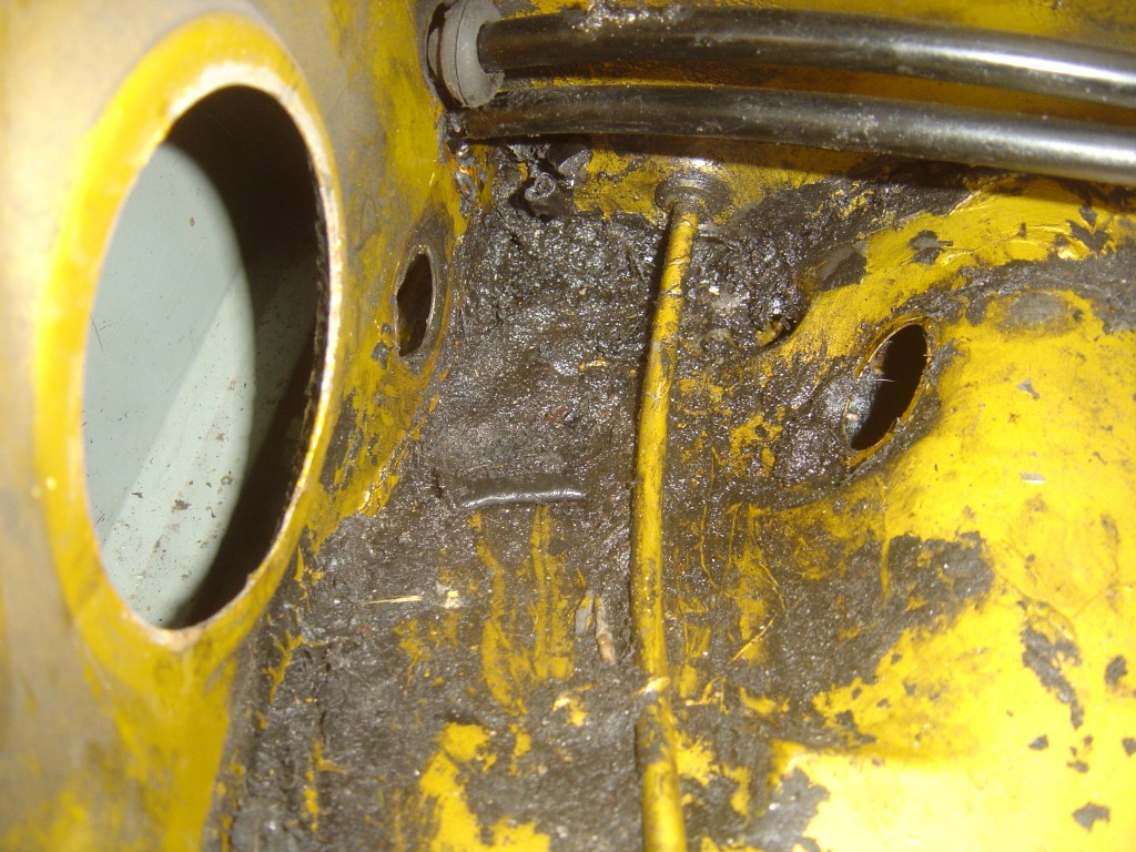

Freaking oil lines took almost 3 hours to remove. I had to cut the lines every 6 or so inches, let that section of oil drain out, then cut the rest of the way through. I've never felt like I was so well lubricated in my life (IMG:style_emoticons/default/blink.gif) Getting the top line was fun too.

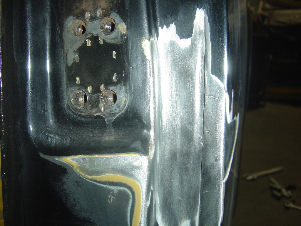

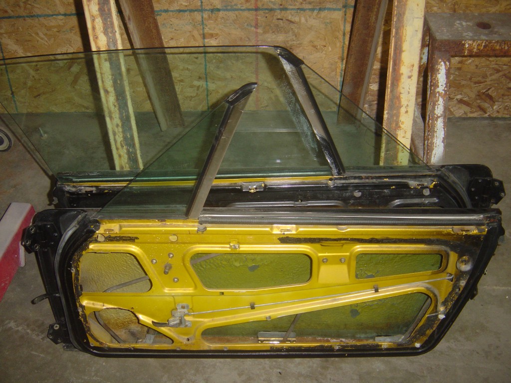

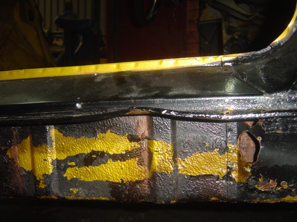

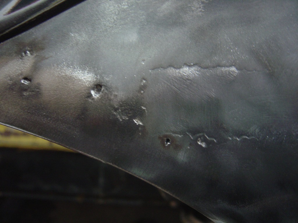

In other news, the car has had the drivers rear quarter replaced, and I am almost certain both front fenders have been replaced unless the stitch welded seam is a 6 only assembly procedure. there is no gold paint under the black on the fronts either.
I have a feeling the car was wrecked early on and was repaired with factory panels by a very competent shop. It would be interesting to know the whole story though (IMG:style_emoticons/default/confused24.gif)

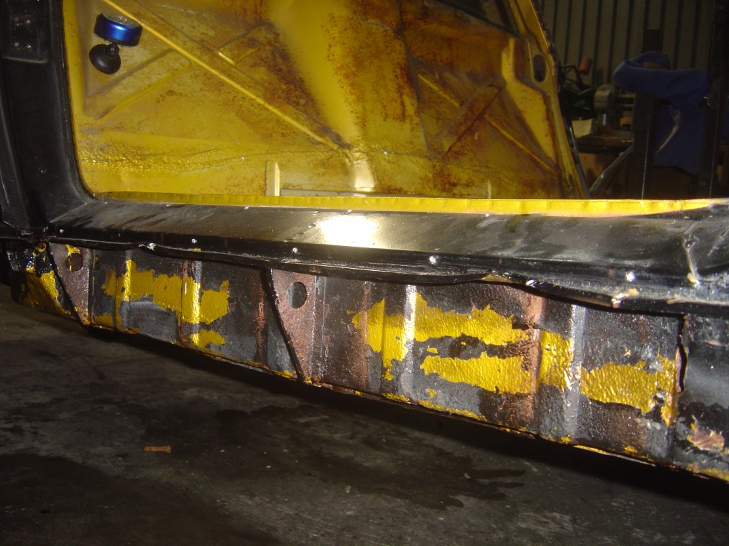

Anyway, the car is completely dismantled now except for the suspension. Hopefully I will get it on the rotiserrie tomorrow and drop the suspension, then commence with scraping the undercoating and seam seaer prior to blasting it (IMG:style_emoticons/default/smile.gif)

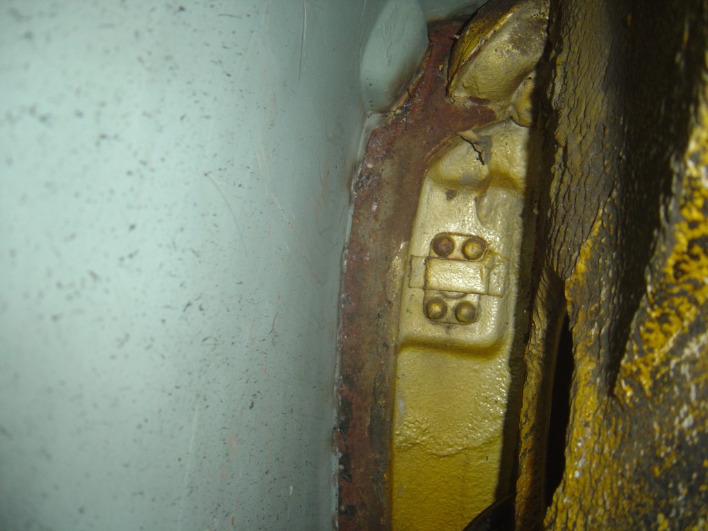

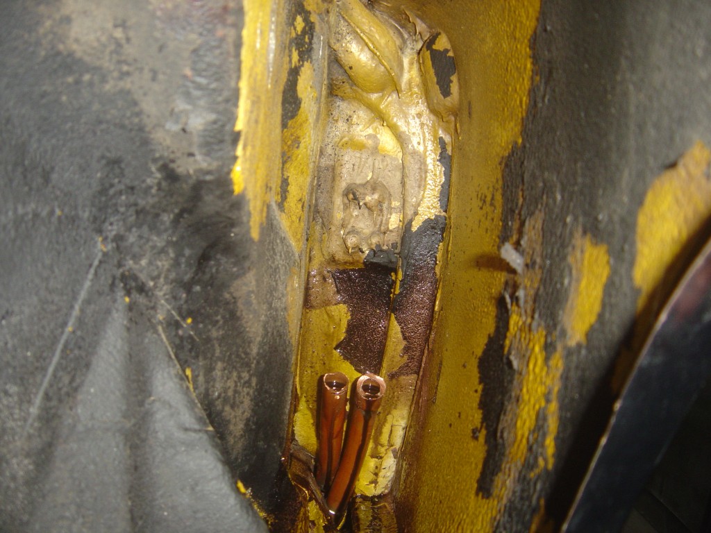

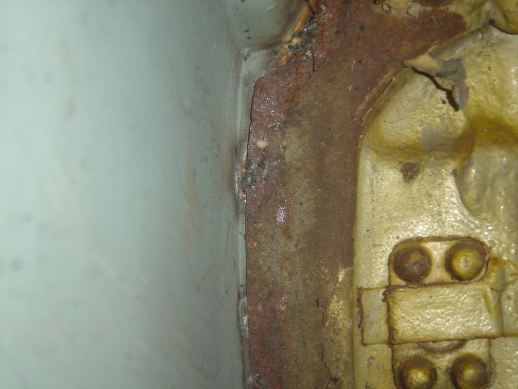

scotty b   Does anyone know what this is ? It is on the drive...   Jun 19 2012, 07:17 AM
Cairo94507   Did the seat belt tongue sit in that? Shot in the...   Jun 19 2012, 07:25 AM
sixerdon   Did the seat belt tongue sit in that? Shot in th...   Jun 19 2012, 07:50 AM
6freak   Did the seat belt tongue sit in that? Shot in th...   Jun 20 2012, 03:13 PM
cwpeden   The piece on the inner long is a seatbelt holder. ...   Jun 19 2012, 07:26 AM
scotty b   The piece on the inner long is a seatbelt holder....   Jun 19 2012, 07:28 AM
