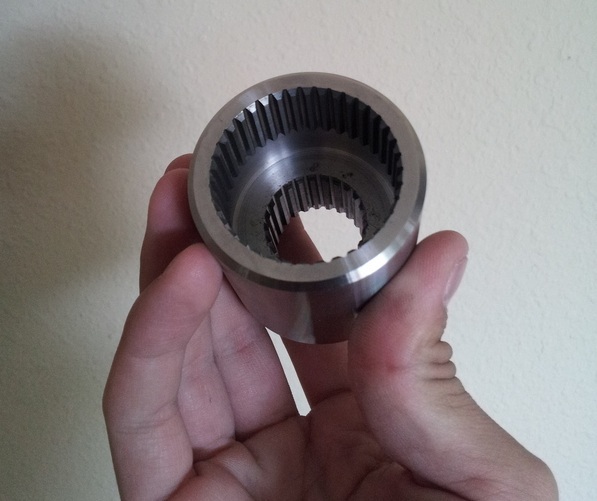

Im going to try and not jinx myself, but it seems quite close now... Im almost done with the prototype rev2 on the cradle. I had to go back and redo the mounts to be compatible with the 6 cyl motors. I plan to finish it in the next two days, and hopefully be able to set up for production next weekend, get all the laser cutting and tubing in early next week and do a production run of 10 the first weekend of august.
At that point i will be able to sell the basic drive line kit, including the cradle, axles, 2wd coupler (pictured below). The back plate is being a pain, the original machinist decided to move shops and had not gotten to the plates for months, so I pulled them and now am searching for another capable shop.
a shifting solution for the 901 and subi box is next on the list after that.
my apologies guys, going back and looking at my posts its laughable at how many times ive said, "really close, almost there," I promise at the time it really felt that way (IMG:style_emoticons/default/headbang.gif)
Just seems like there's been setback after setback, starting a fab business is hard, who knew?!? but I'm still in this, trust me (IMG:style_emoticons/default/biggrin.gif)
single piece, high strength alloy, made here in the US (at the expense of any profit on the piece). really cool!
