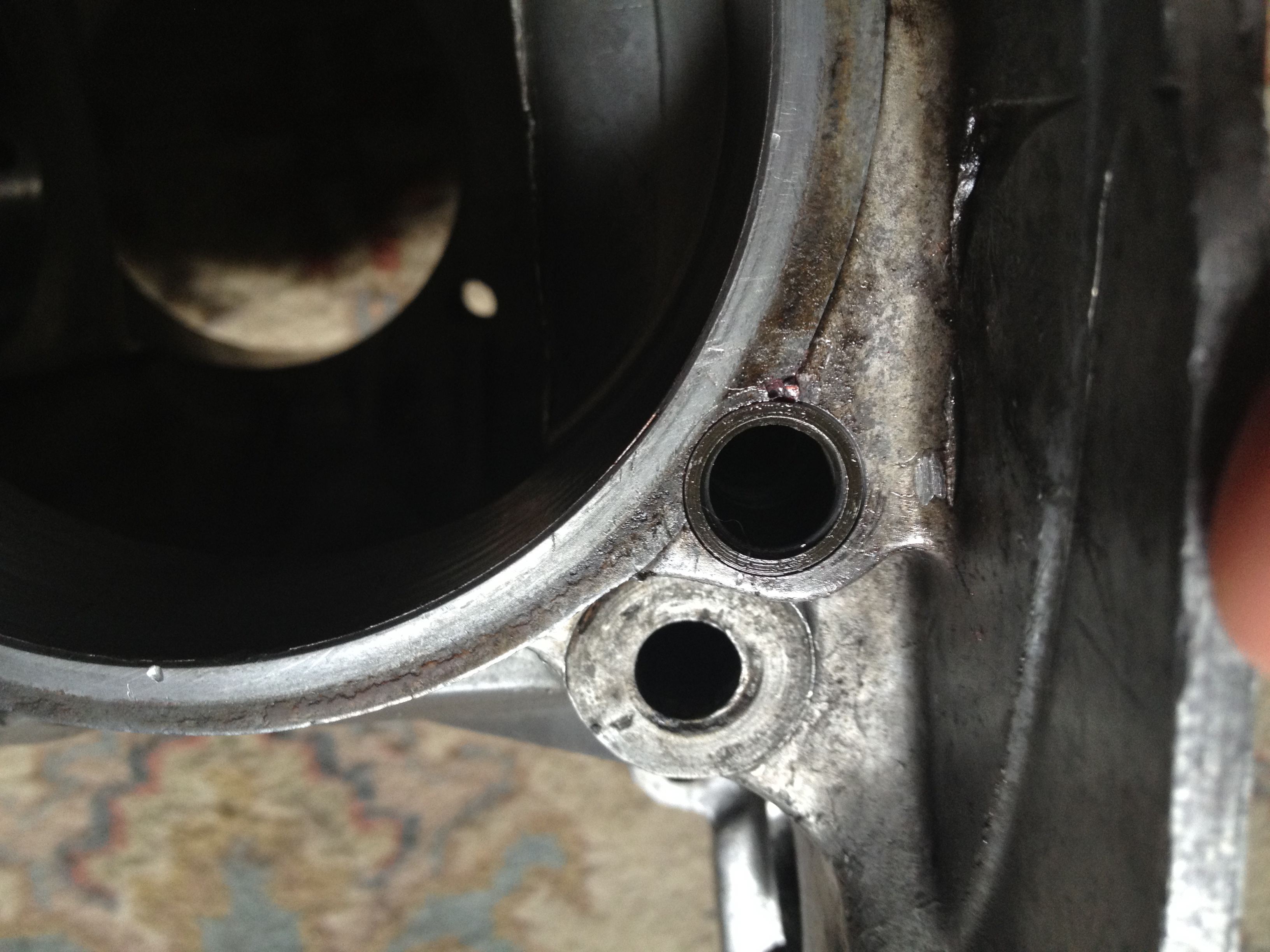

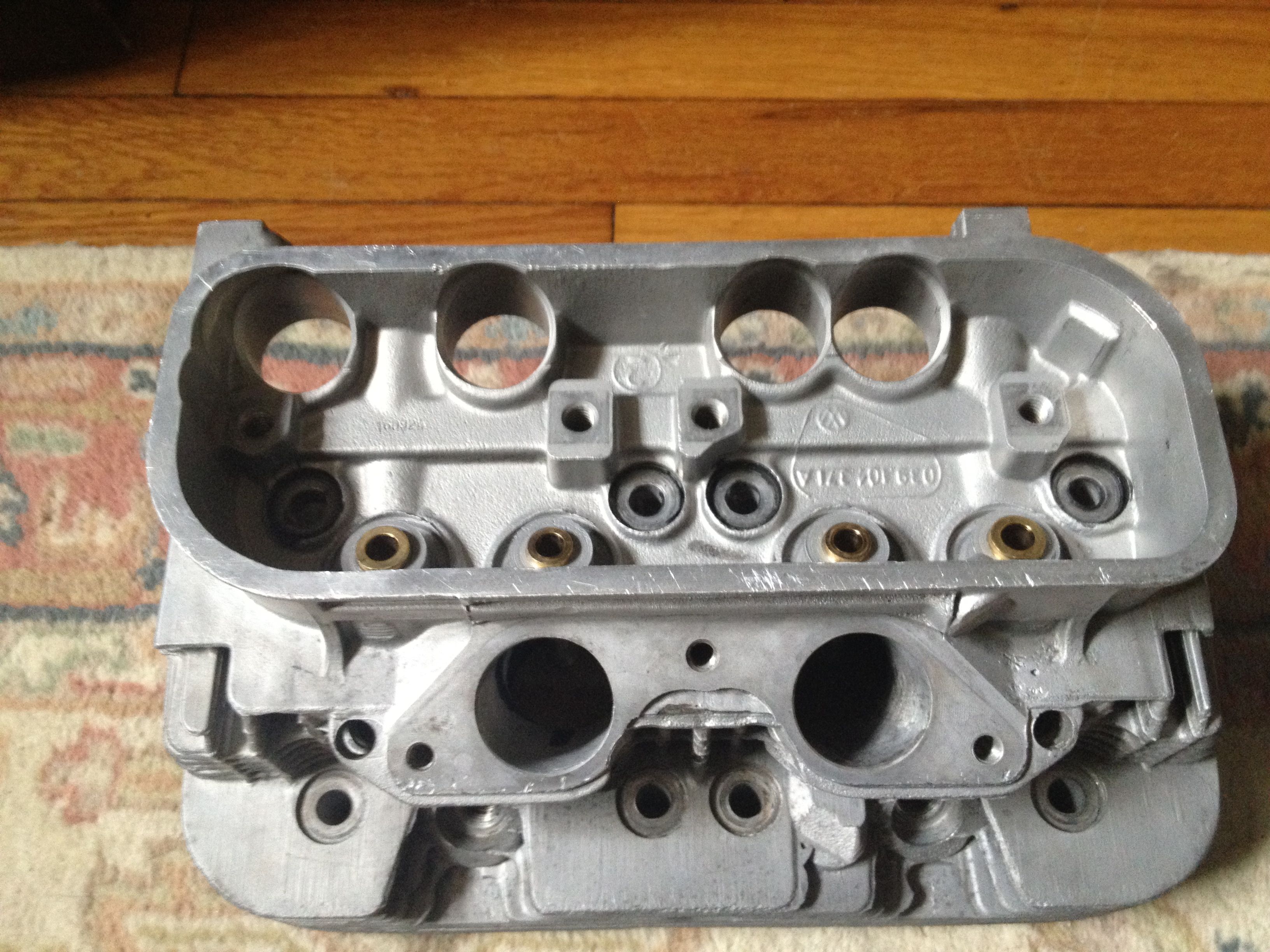

It also looks like there was a little bit of porting done on the intake track....not to shabby.
Unfortunately my machinist could not get the stud out either, so he drilled it out and put in an insert. I think he did a pretty damn good job!
