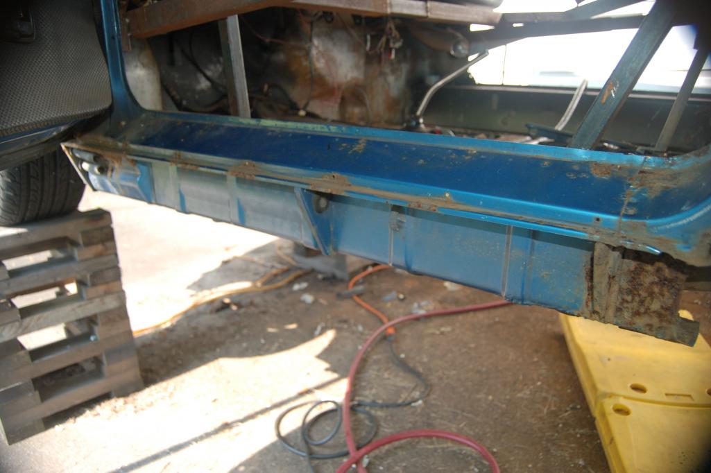

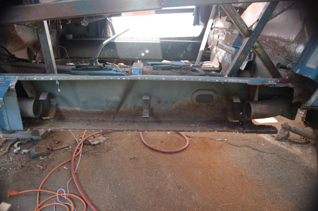

So I got to re-meet dlee6204 today and see his sweet 914. Its awesome to have all you guys collection of knowledge and meet up with nice folks locally who love 914s. Can't wait till I can go ridin around w some of you 914 peps. So back to the build pics, these are from July 2011 and are of the bad dr side. I remember being so bummed about having to open up the whole dr long. I guess I was in denial, that I might not have to. Wrong! But I had to get rid of all the rust I could see. So out came the drill and grinder and welder.

fasthonda   Rust wise that car really isn't too bad imo. N...   Aug 1 2012, 07:25 PM
metalmorphosis   Hey Michael I just use a drill I do own a spot wel...   Aug 1 2012, 08:21 PM

metalmorphosis   Heres a little more of the pass side going back to...   Aug 2 2012, 06:52 PM

metalmorphosis   A lil more   Aug 4 2012, 07:12 PM
metalmorphosis   And here its starting to get some repairs and some...   Aug 4 2012, 07:24 PM
