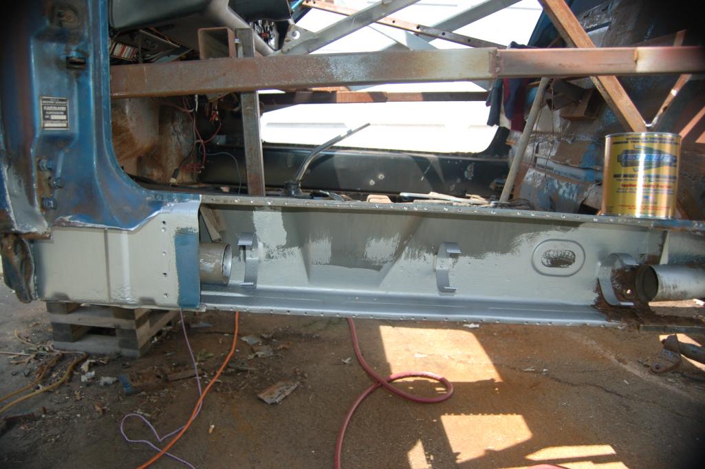

metalmorphosis
post Aug 4 2012, 07:24 PM
Posts: 90
Joined: 31-July 12
From: winston-salem nc
Member No.: 14,743
And here its starting to get some repairs and some good ol Rust Bullet.

metalmorphosis   And here its starting to get some repairs and some...   Aug 4 2012, 07:24 PM
