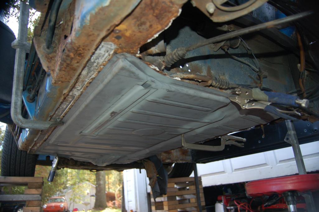

This is my 914 back in 2010 when I started the rust repair. I'm almost done with
rust repair now and I have lots of pics but I have to resize and post latter. It seems like these pics are gonna work even though they are big so I guess we'll see what happens.

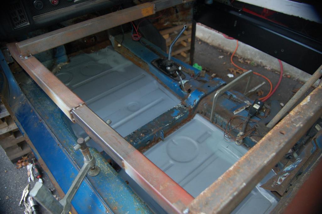

Well I had hoped to paint my engine compartment and the bottom of the floors this wkend but fell just short. But aside from masking off a few things and minor prep work I am ready to paint next work session. Anyway back to the build pics, these next 2 are a little out of chronological order and are from around oct 2010. They just show the first test fit of the driver side floor. I was probably tring to decide where to cut the front edge of the floor. Thats all for now may get more posted in an hr or so.
