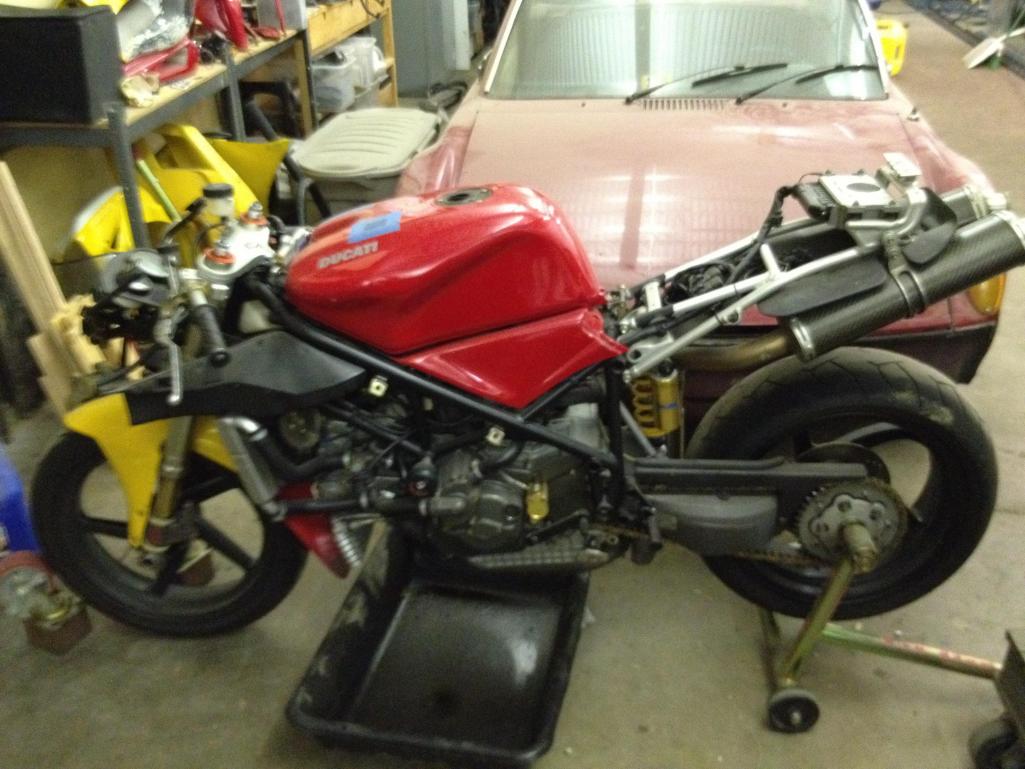

QUOTE(smj @ Aug 8 2012, 02:35 PM) *
That red front fairing sitting on your bench next to the bike battery looks vaguely Ducati-ish to me... (IMG:style_emoticons/default/shades.gif)
Good eye sir! That is indeed a Ducati 996 fairing, my "other" toy. You can kind of see its butt sticking up in front of the 914, my track only bike.
