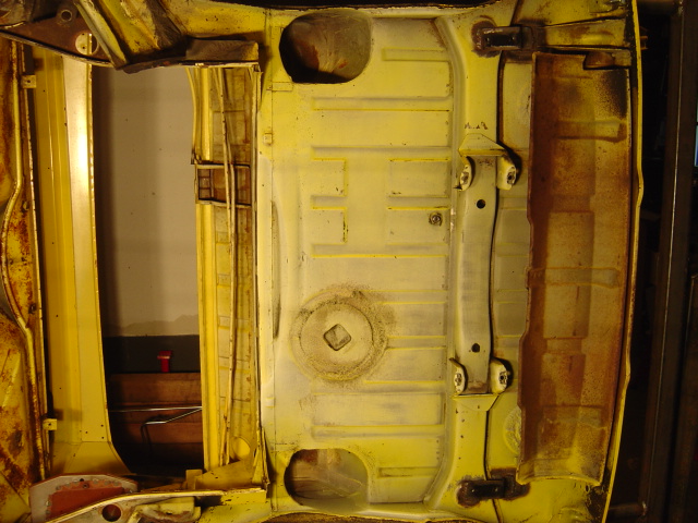

Well, while the guys out west were having a great time with track time, autocross and wall to wall 914s, there was very little to do here in Massachusetts except continue to prep for paint work. Next step was to degrease the area over the engine and transmission. Came out very nice.

william harris   Well, while the guys out west were having a great ...   Jun 6 2004, 06:06 PM
