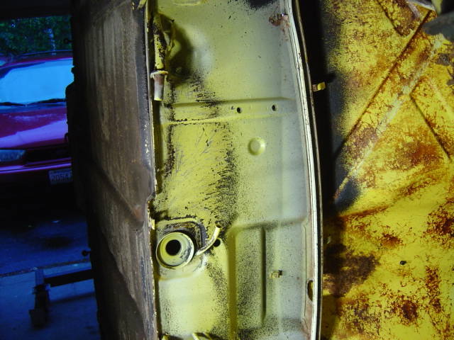

william harris   Since the weather was good, I also took the time t...   Jun 13 2004, 09:42 PM
Racer Chris   I say remove as much sealer as you can in as many ...   Jun 13 2004, 09:50 PM

william harris   Here's the front trunk.   Jun 13 2004, 09:56 PM
