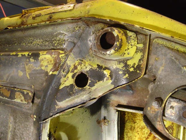

I wanted to remove as much undercoating as possible to make sure there was good solid metal underneath. So far no bad areas.

Racer Chris   William, I am impressed with your diligence at rem...   Jun 10 2004, 06:51 PM
