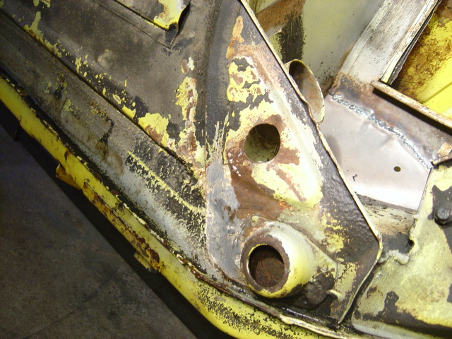

william harris
post Jun 6 2004, 06:11 PM
914 Restorer
Posts: 1,459
Joined: 9-January 04
From: Hamilton, MA
Member No.: 1,539
Here's the other side.
