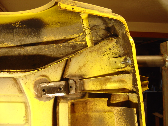

The undercrap was also about one-half inch thick at the rear panel.

william harris   The undercrap was also about one-half inch thick a...   Jun 6 2004, 06:14 PM
william harris   I intend to strip every spot of this undercoating....   Jun 6 2004, 06:16 PM
