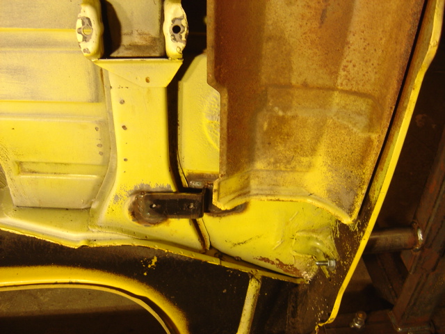

william harris   Spent most of the weekend trying to clean up the r...   Jun 13 2004, 09:26 PM
william harris   I'm sure my techinque is a little different, I...   Jun 13 2004, 09:29 PM
william harris   I can't believe how thick this crap is! I...   Jun 13 2004, 09:30 PM
william harris   I've learned that any place on the car with PO...   Jun 13 2004, 09:33 PM
william harris   Here's the same area from the other side. Rac...   Jun 13 2004, 09:35 PM
william harris   Question for the group: how far should I go in re...   Jun 13 2004, 09:38 PM
Racer Chris   I'm looking William. I'm surprised to see ...   Jun 13 2004, 09:41 PM

Racer Chris   I say remove as much sealer as you can in as many ...   Jun 13 2004, 09:50 PM
