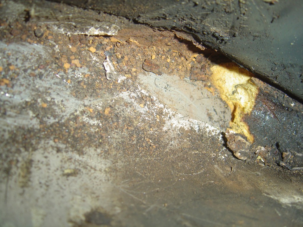

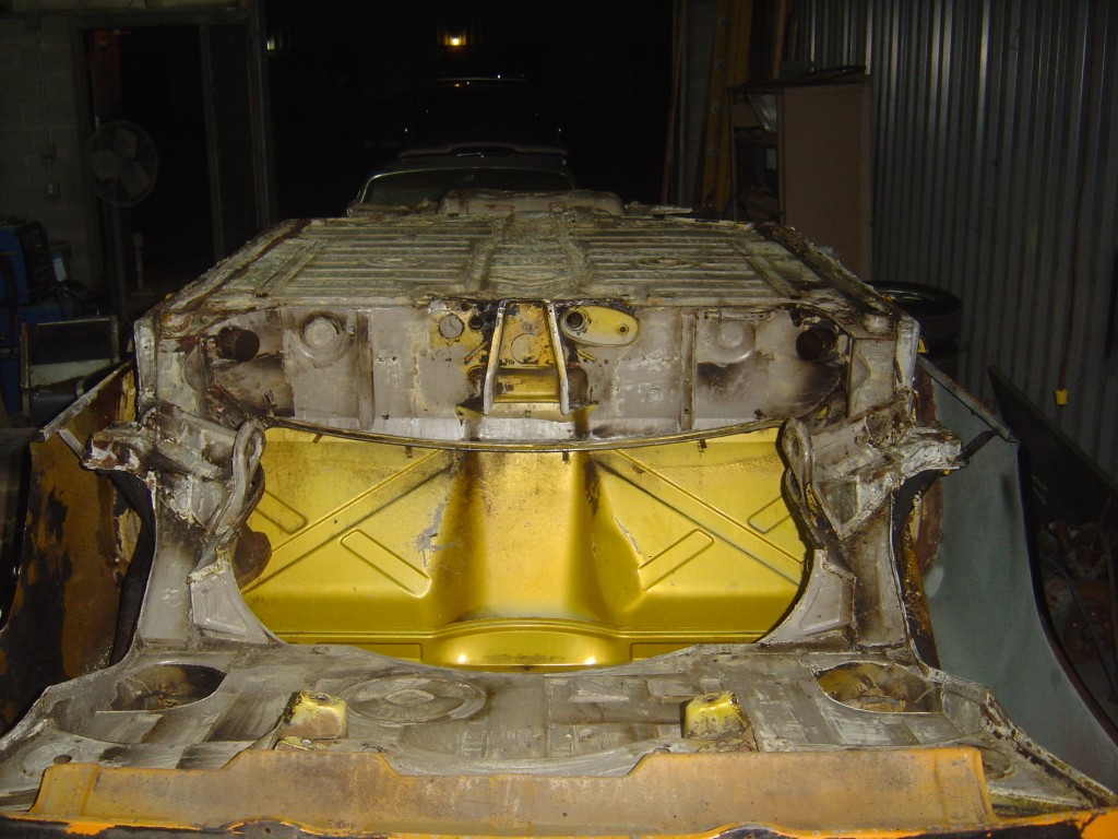

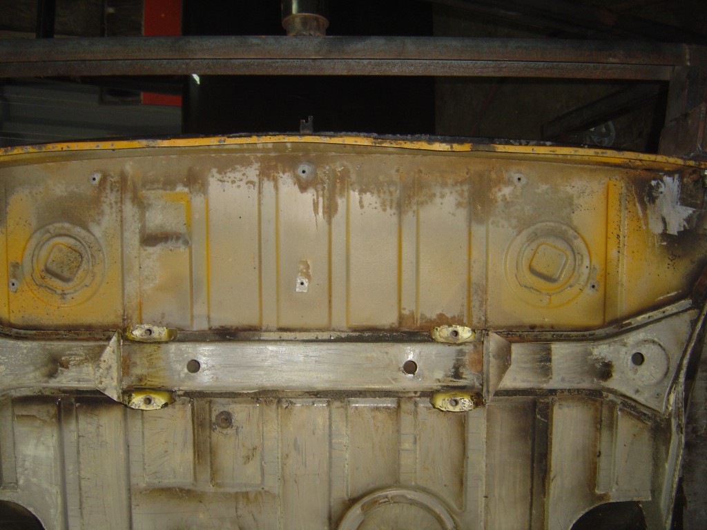

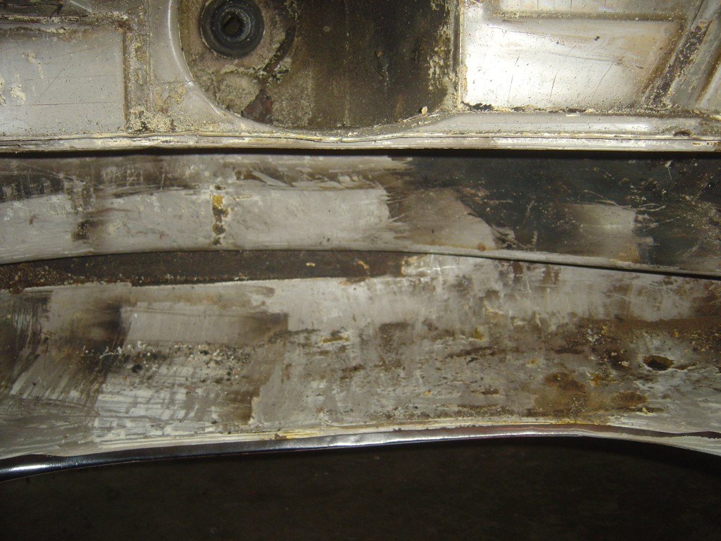

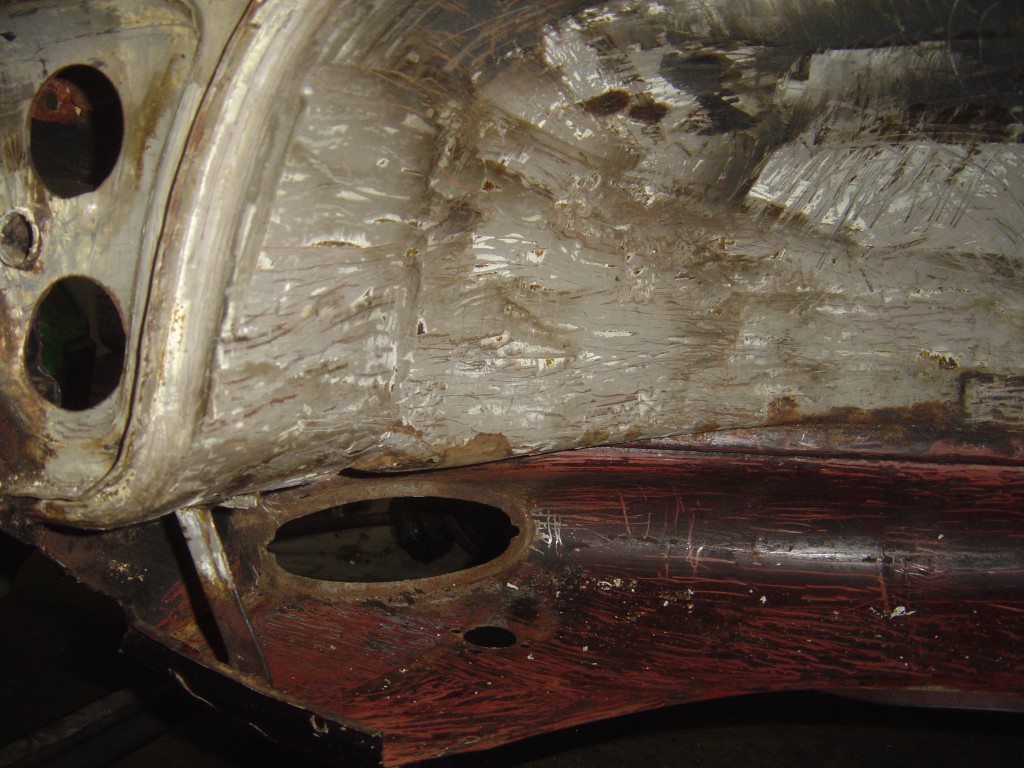

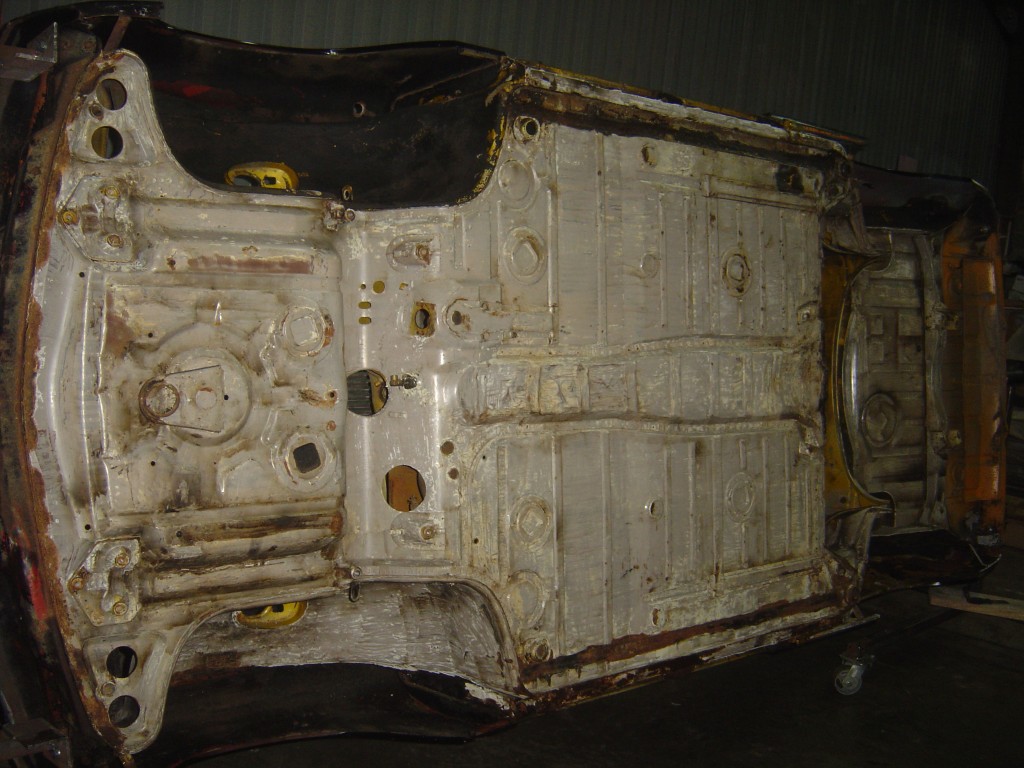

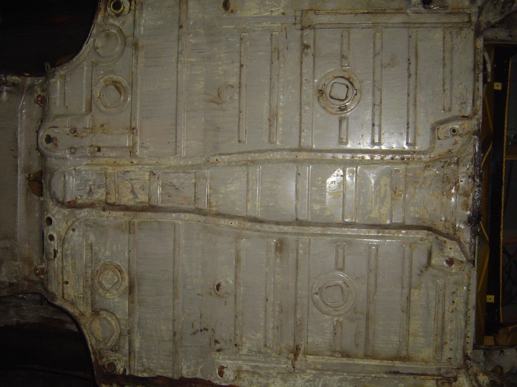

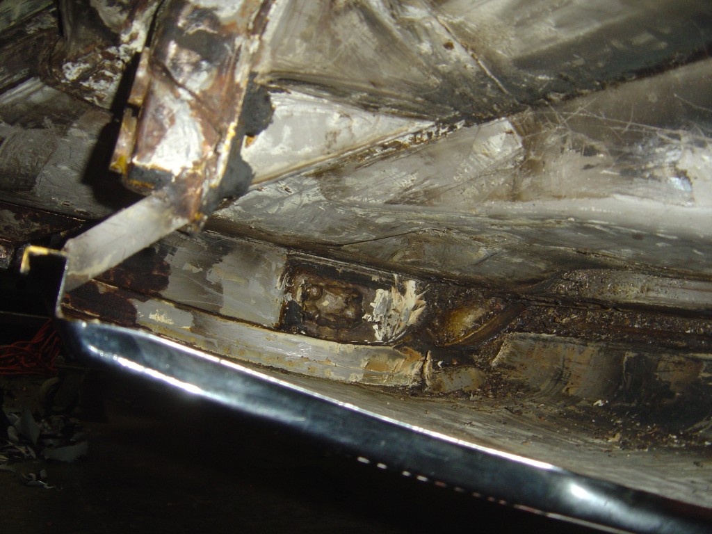

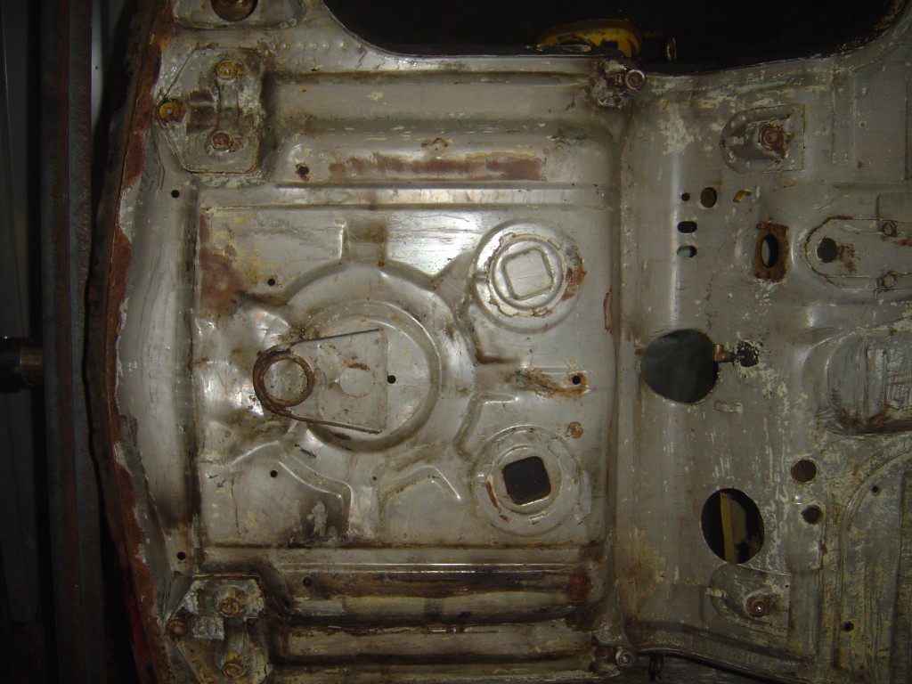

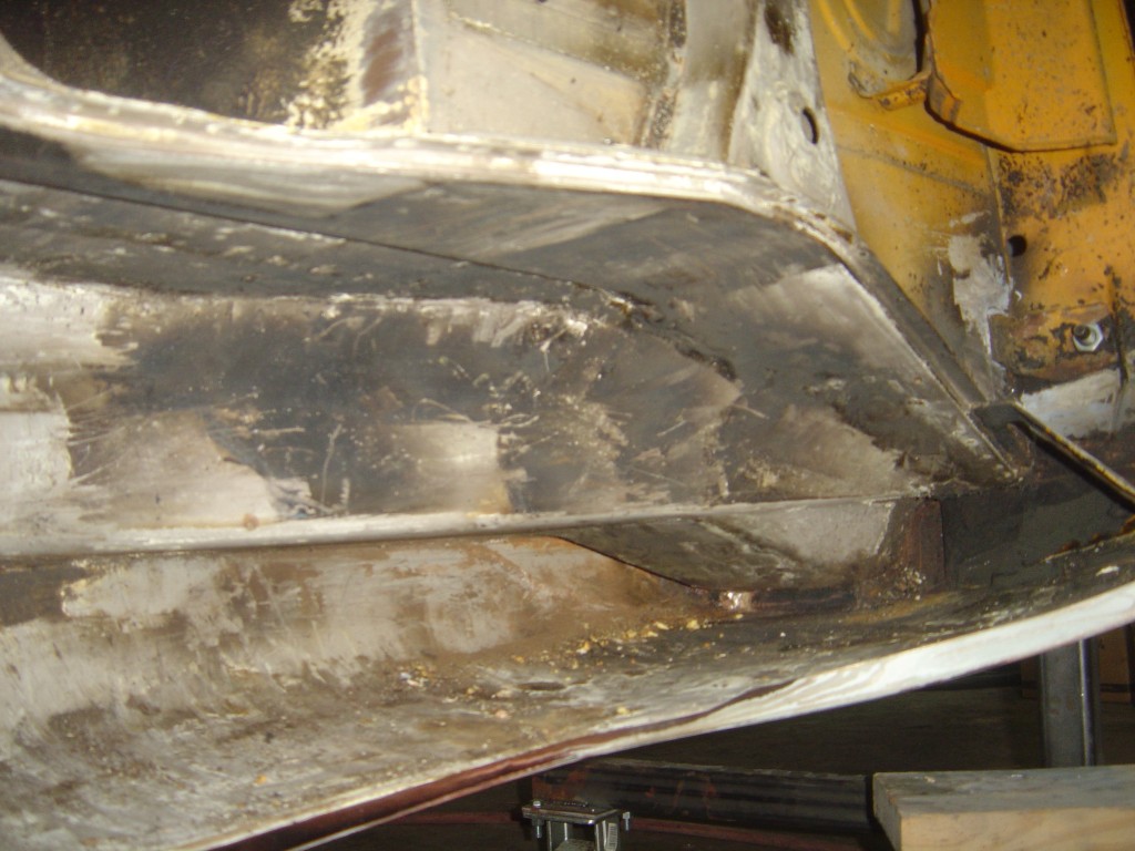

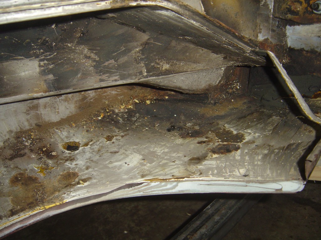

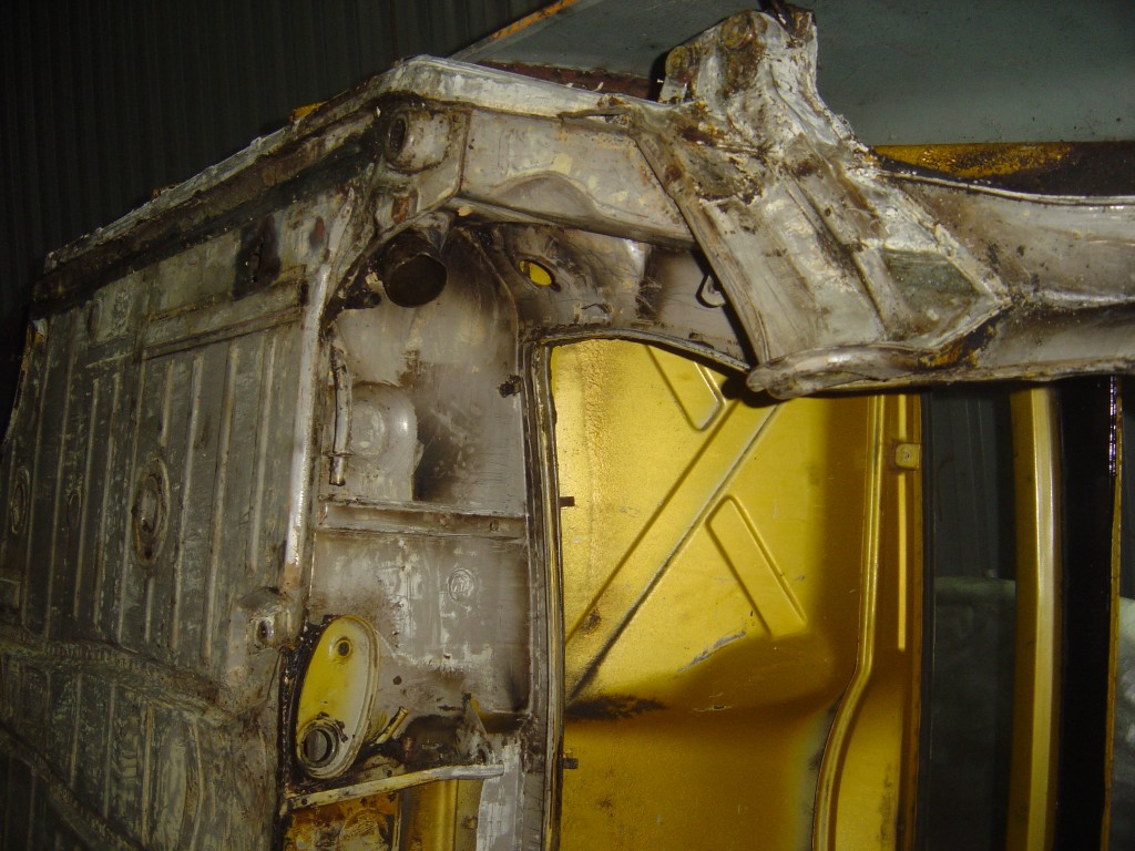

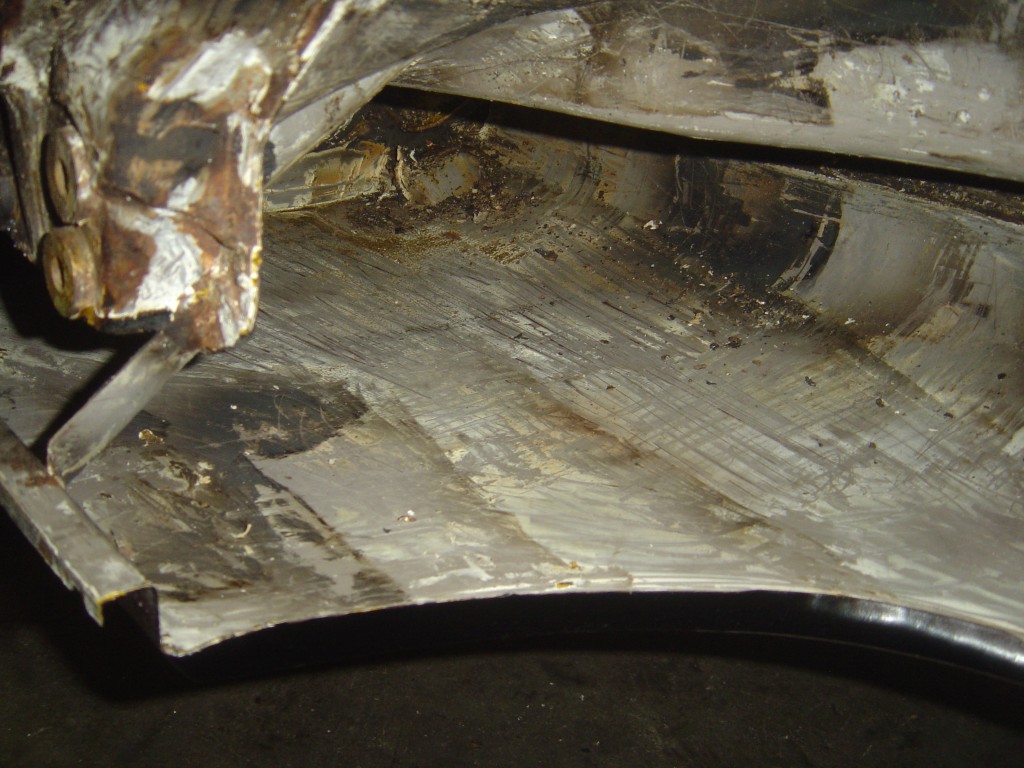

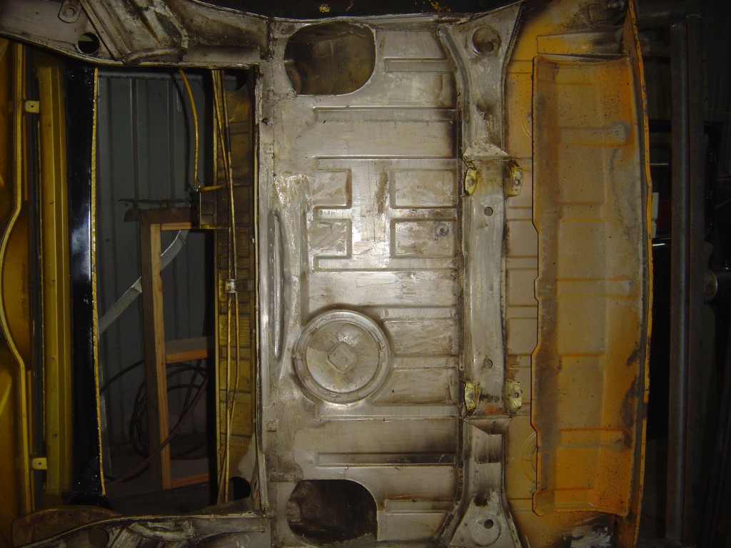

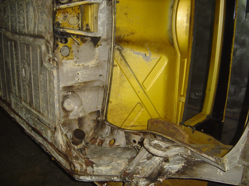

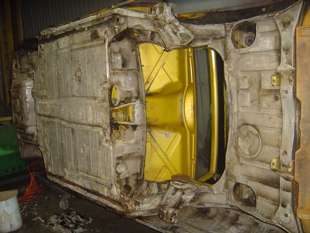

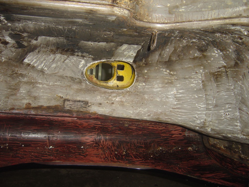

Between my dad and I there is almost a full week just in scraping off the undercoating, and I still have one wheel well to go (IMG:style_emoticons/default/blink.gif) Only found a few more SMALL rust spots to fix. One in the floor, one on the engine shelf under the battery tray and the spot on the long where the oil ines had been run. Media blasting will get the remainder of the undercoating bits off (IMG:style_emoticons/default/smile.gif) Also note the rust that was underneath the foam in the rear corners. It's always a good idea to remove that stuff
