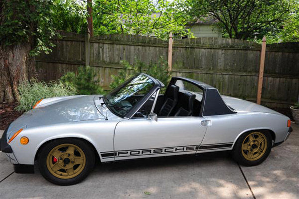

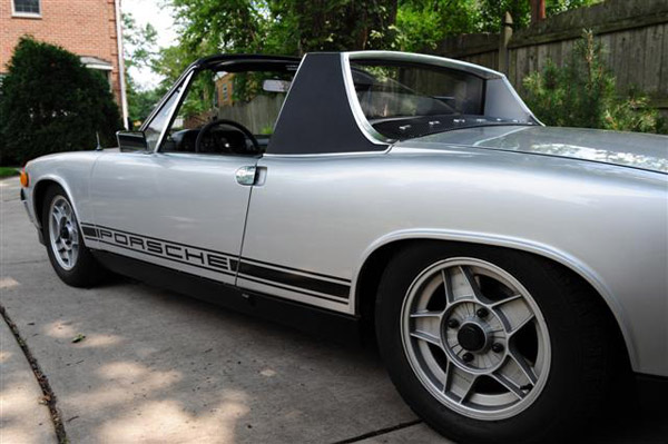

Great wheels. I have a set of 15x7 that should fit on a narrow body. Not confirmed yet since my car has a have case of jack-stand at the moment.
I found the silver car on the internet with silver ATS rims and photoshoped the color to gold, pretending to be Mag wheels. Yes, very light, made in Germany, where ATS is a very popular aftermarket brand like BBS but not as $$$. I believe ATS makes some wheels for newer Mercedes. Attached image(s)
