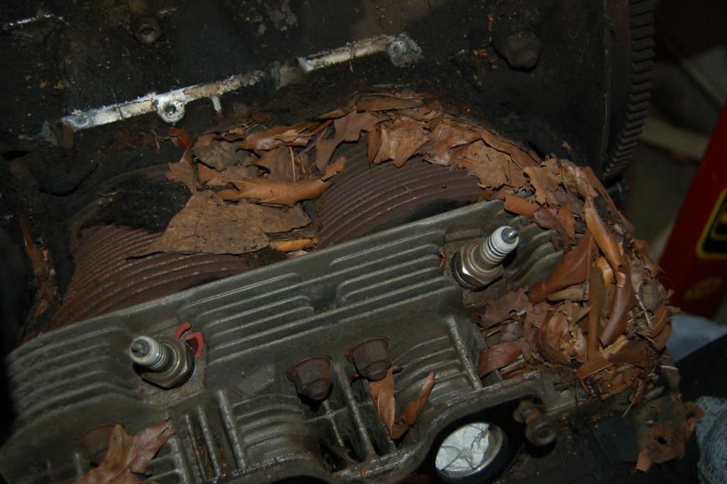

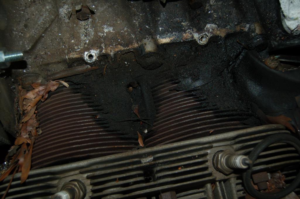

Hello again everyone, its been almost 2 wks since posting anything. I just got back from my whirlwind trip to new england and I'm glad to be back in the land of sweet tea and biscuits. Anyway back to the build thread pics, heres some of the motor when I started takin it apart to clean it up. I didn't rebuild it as it runs fine just wanted to clean it. Once I removed the tins I found all this, don't know how the poor thing cooled itself.
