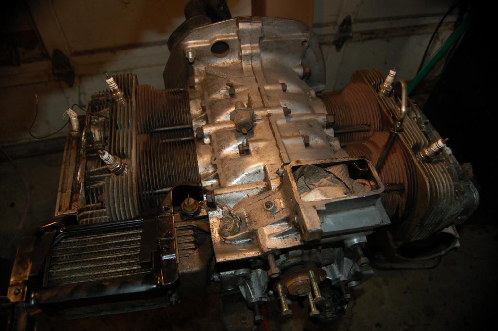

jockellis   Could you talk some more about the wheels. Did you...   Oct 6 2012, 10:49 PM
metalmorphosis   I got the wheels for super cheap from a guy I used...   Oct 6 2012, 11:18 PM
jockellis   I work in a machine shop with over 50 five axis CN...   Oct 7 2012, 02:08 PM
metalmorphosis   I did all this 3/4 yrs ago so I don't remember...   Oct 7 2012, 03:59 PM
