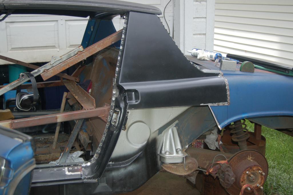

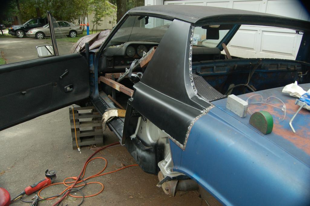

Heres more of the drivers side goin back together except its permenent now. No more clamps and sheet metal screws, we have spot welds! Also, as you can see I've painted everything so my new metal is protected. So now I've got a bare doorjam that needs a new vin sticker. Although that will have to wait till it gets painted which may be awhile. On another note I found some pics last night that I couldn't find eariler that show more of the pass long repair in detail. I'll post a few of them later even though they will be a little out of order.

metalmorphosis   Heres more of the drivers side goin back together ...   Aug 20 2012, 10:10 PM
metalmorphosis   A few more.   Aug 20 2012, 10:12 PM
