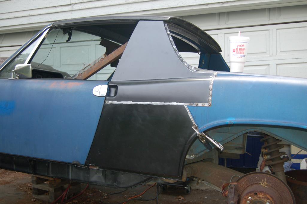

metalmorphosis   Hello again everyone, its been almost 2 wks since ...   Aug 19 2012, 06:24 PM
metalmorphosis   Heres a few after shots.   Aug 19 2012, 06:26 PM

metalmorphosis   Heres more of the drivers side goin back together ...   Aug 20 2012, 10:10 PM
metalmorphosis   A few more.   Aug 20 2012, 10:12 PM
metalmorphosis   Here we go back to the lost but now found out of o...   Aug 23 2012, 08:50 PM
metalmorphosis   Inner wheelhouse   Aug 23 2012, 08:55 PM
metalmorphosis   All traces of the k-rusty long gone and the new pc...   Aug 23 2012, 09:01 PM
dlee6204   Holy Smokes! :woohoo:   Aug 23 2012, 09:04 PM
metalmorphosis   Inner long half being installed and presto change-...   Aug 23 2012, 09:08 PM
