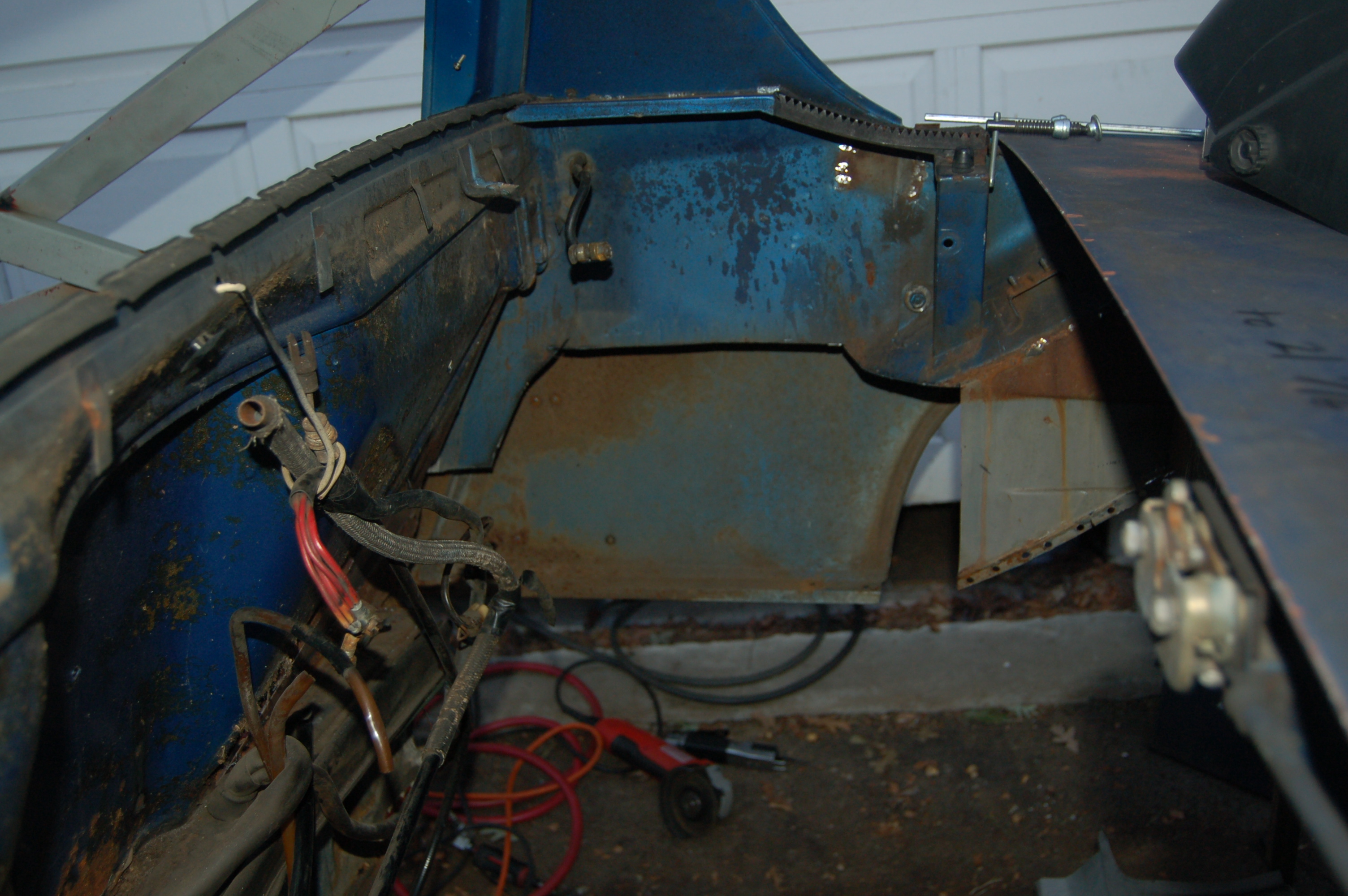

Inner wheelhouse

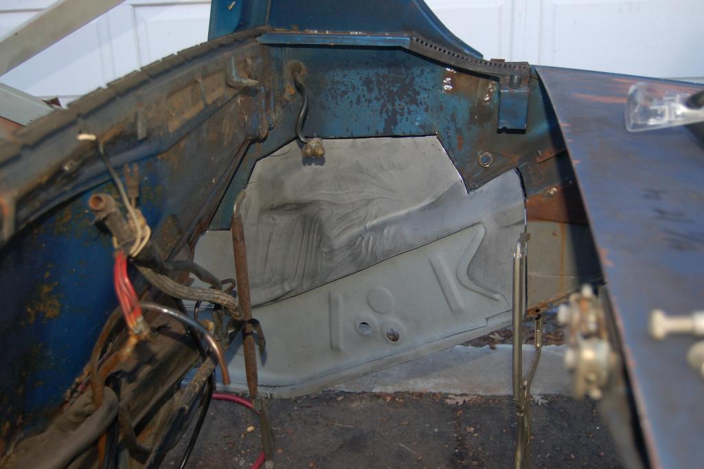

metalmorphosis   Here we go back to the lost but now found out of o...   Aug 23 2012, 08:50 PM
metalmorphosis   Inner wheelhouse   Aug 23 2012, 08:55 PM
metalmorphosis   All traces of the k-rusty long gone and the new pc...   Aug 23 2012, 09:01 PM
dlee6204   Holy Smokes! :woohoo:   Aug 23 2012, 09:04 PM
metalmorphosis   Inner long half being installed and presto change-...   Aug 23 2012, 09:08 PM
