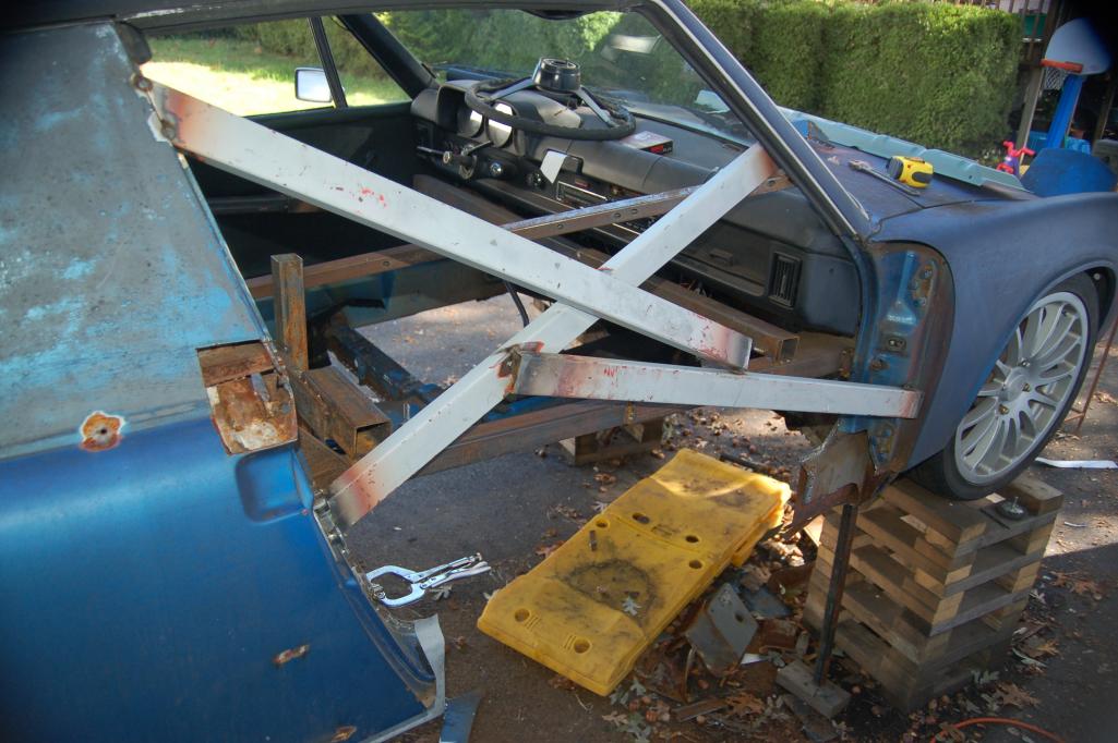

This is my 914 back in 2010 when I started the rust repair. I'm almost done with
rust repair now and I have lots of pics but I have to resize and post latter. It seems like these pics are gonna work even though they are big so I guess we'll see what happens.

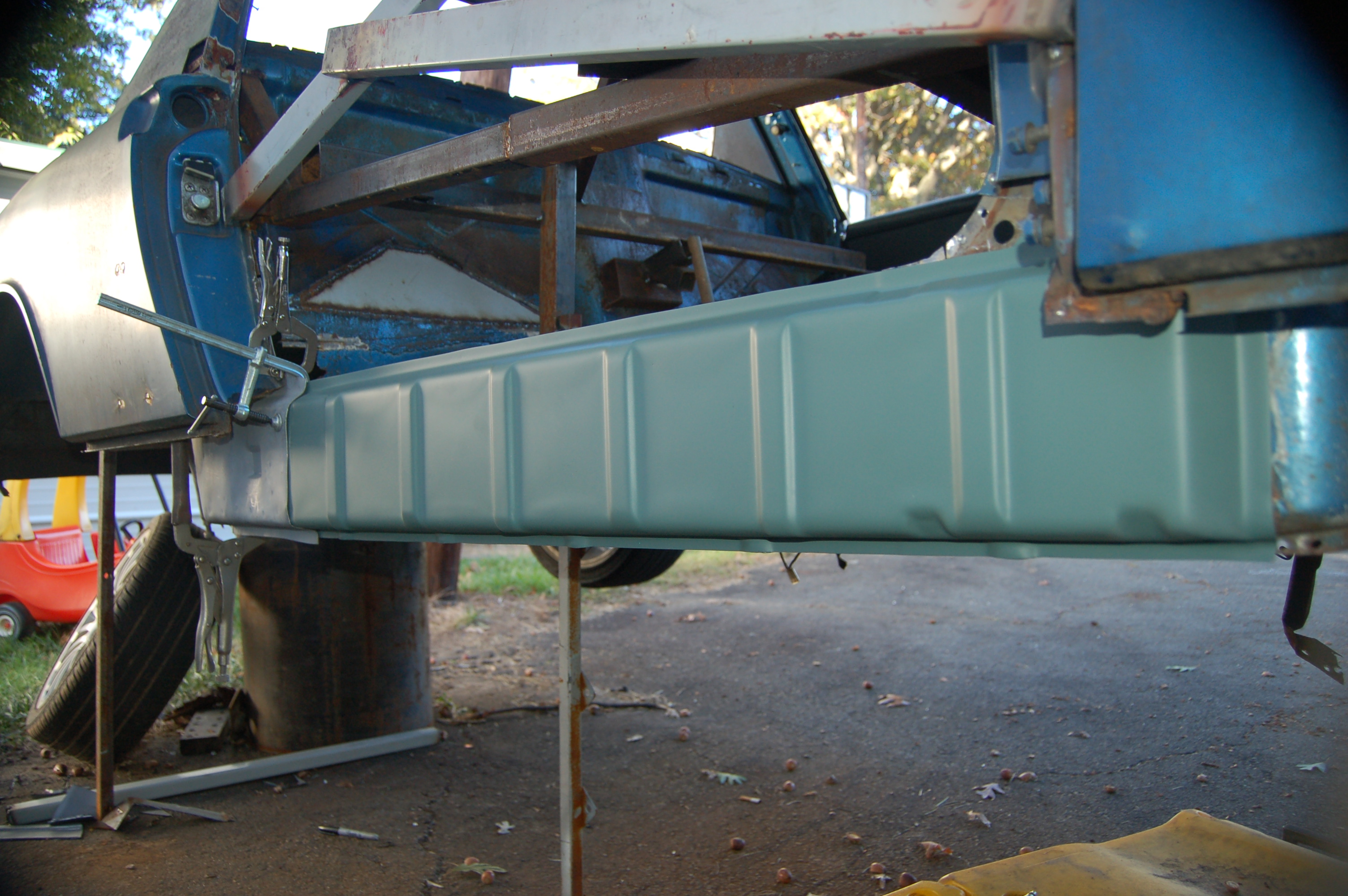

All traces of the k-rusty long gone and the new pcs being test fitted.

metalmorphosis   Heres a few more from 2010. Kind of k-rusty. Hey D...   Jul 31 2012, 09:11 PM
metalmorphosis   Check out my "jackstands"   Jul 31 2012, 09:15 PM
scotty b   That's trouble just waiting to happen. Nice kn...   Jul 31 2012, 09:45 PM

arkitect   Looks like you have it braced thru the doors and a...   Aug 1 2012, 08:08 AM

metalmorphosis   Hey guys I appreciate all of y'alls concern ab...   Aug 1 2012, 11:12 AM

metalmorphosis   And now for the sill plate.   Aug 19 2012, 09:56 PM

metalmorphosis   All traces of the k-rusty long gone and the new pc...   Aug 23 2012, 09:01 PM

metalmorphosis   Inner long half being installed and presto change-...   Aug 23 2012, 09:08 PM
