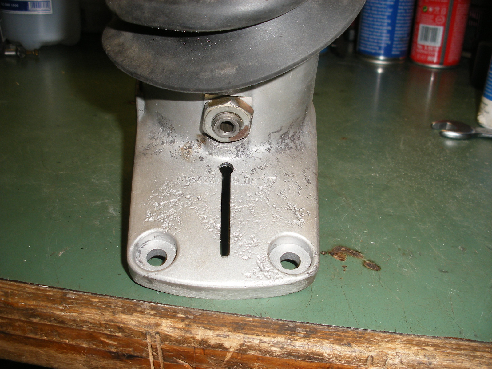

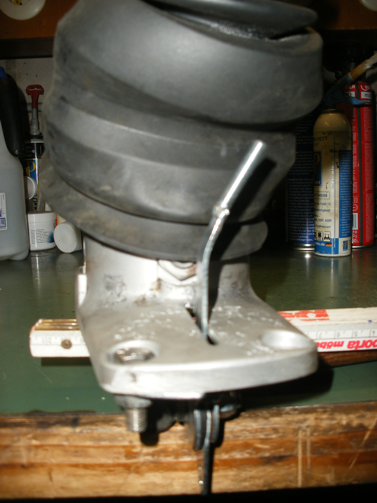

It works also with the 915 shifter but you must add a slot in the middel
of the shifter like the pics show

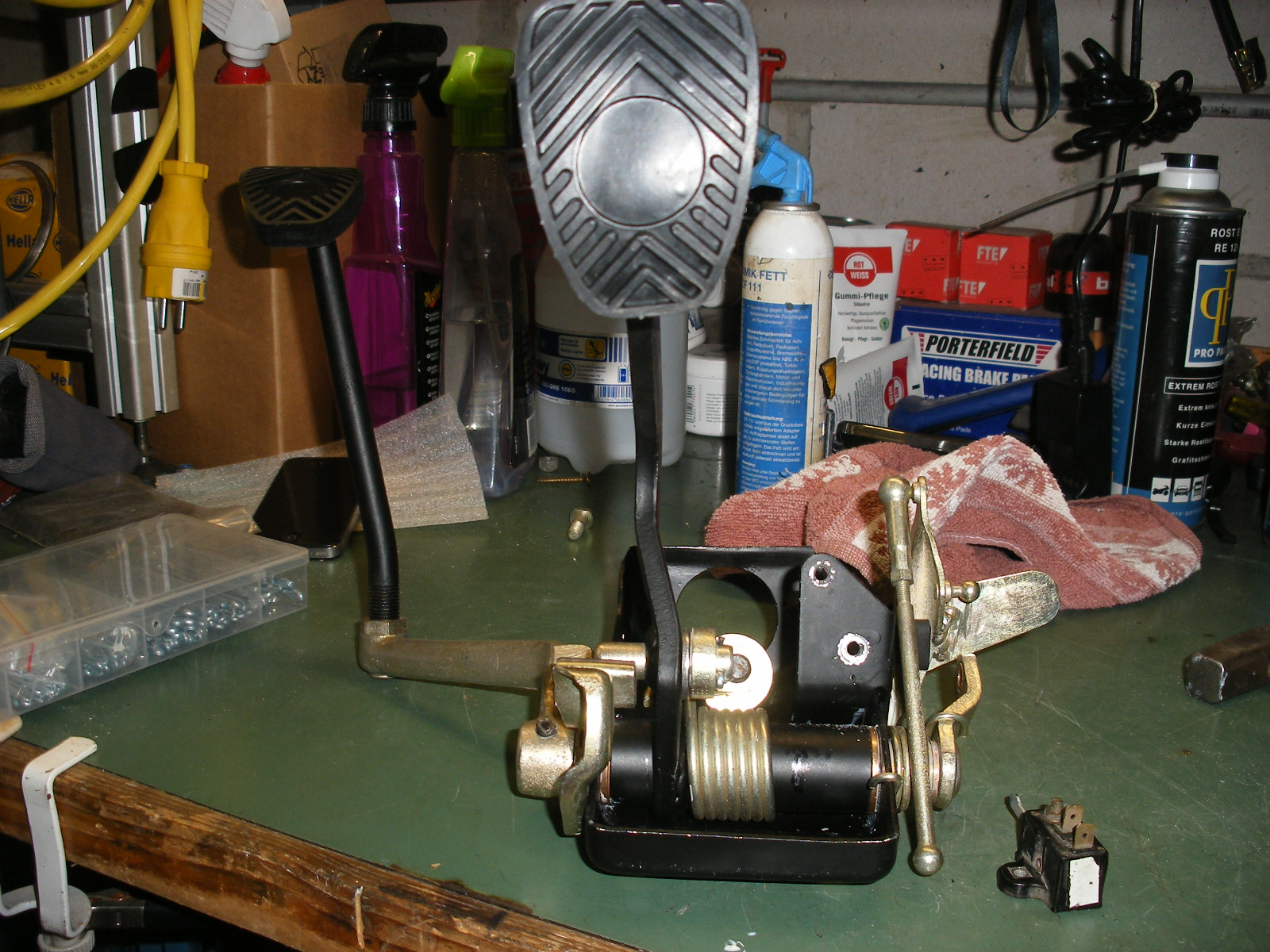

Here a pic of the pedal cluster with the enhancement for the hand throttle
