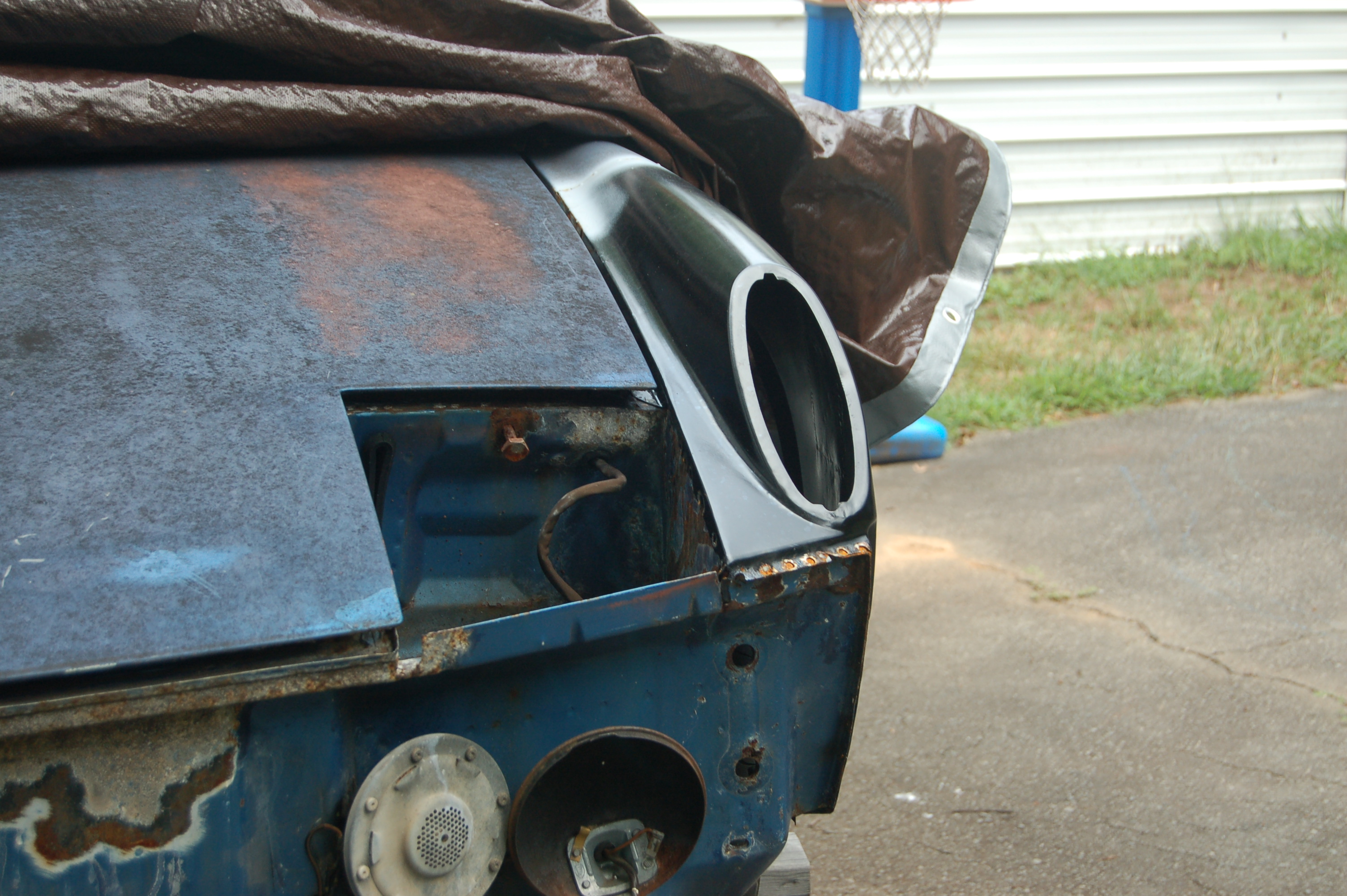

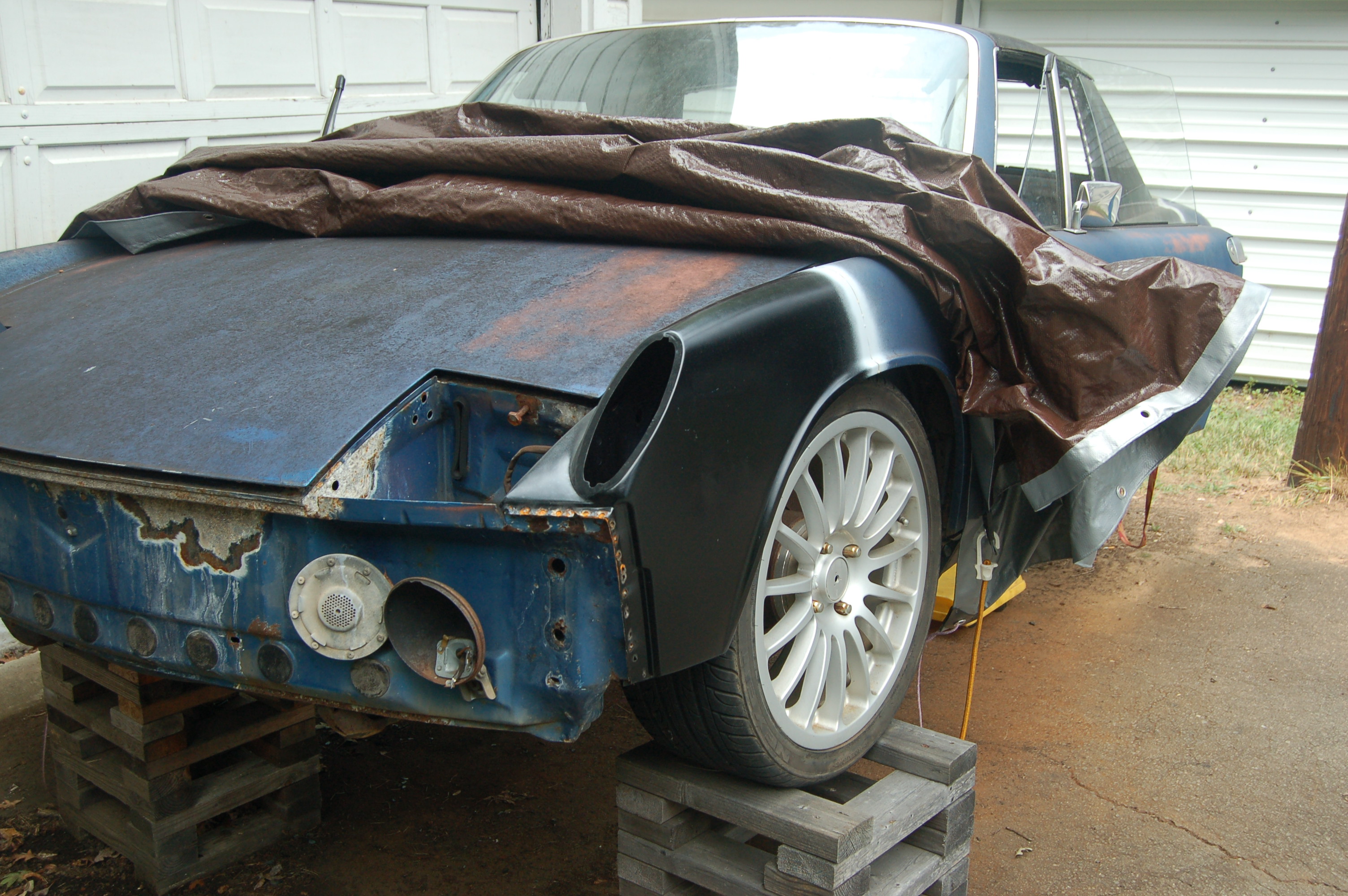

Its been about 2 wks since posting any pics so its time to get back to it! Heres a few of the ft fender tacked back on. I'm leaving it just tacked for now because I think I'm gonna cut it back off again later. It seems a little low compared w the hood and years ago when I pulled the damage out from my fender bender I felt like it may need to be pulled up some more. Even though my car isn't getting any paint right now I want panel fit and gaps to be as good as I can get them. So we'll see how this ends up later.
