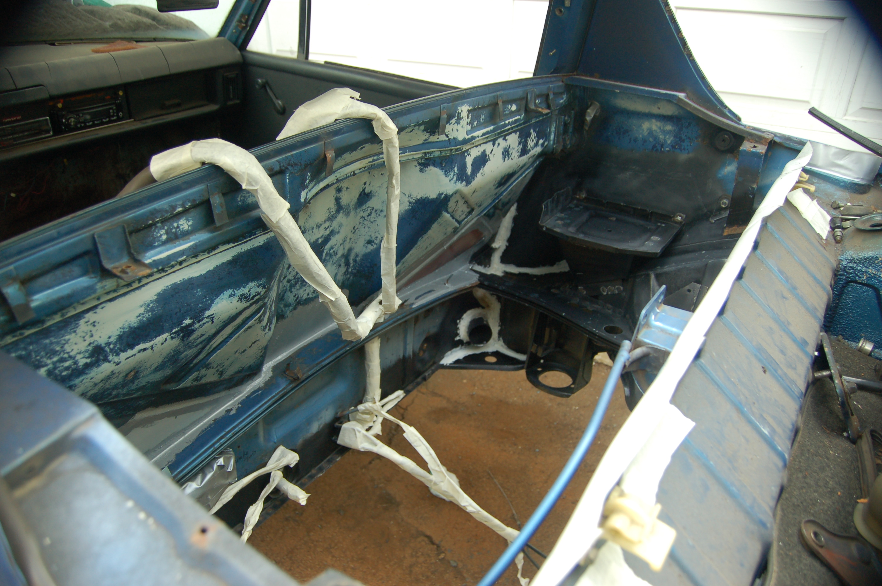

Hello 914 world! Ive been lazily lurking here for way too long and finally decided
to change that tonight. So heres my 1st contribution to all this 914 awesomeness.
This is my 914 back in 2010 when I started the rust repair. I'm almost done with
rust repair now and I have lots of pics but I have to resize and post latter. It seems like these pics are gonna work even though they are big so I guess we'll see what happens.

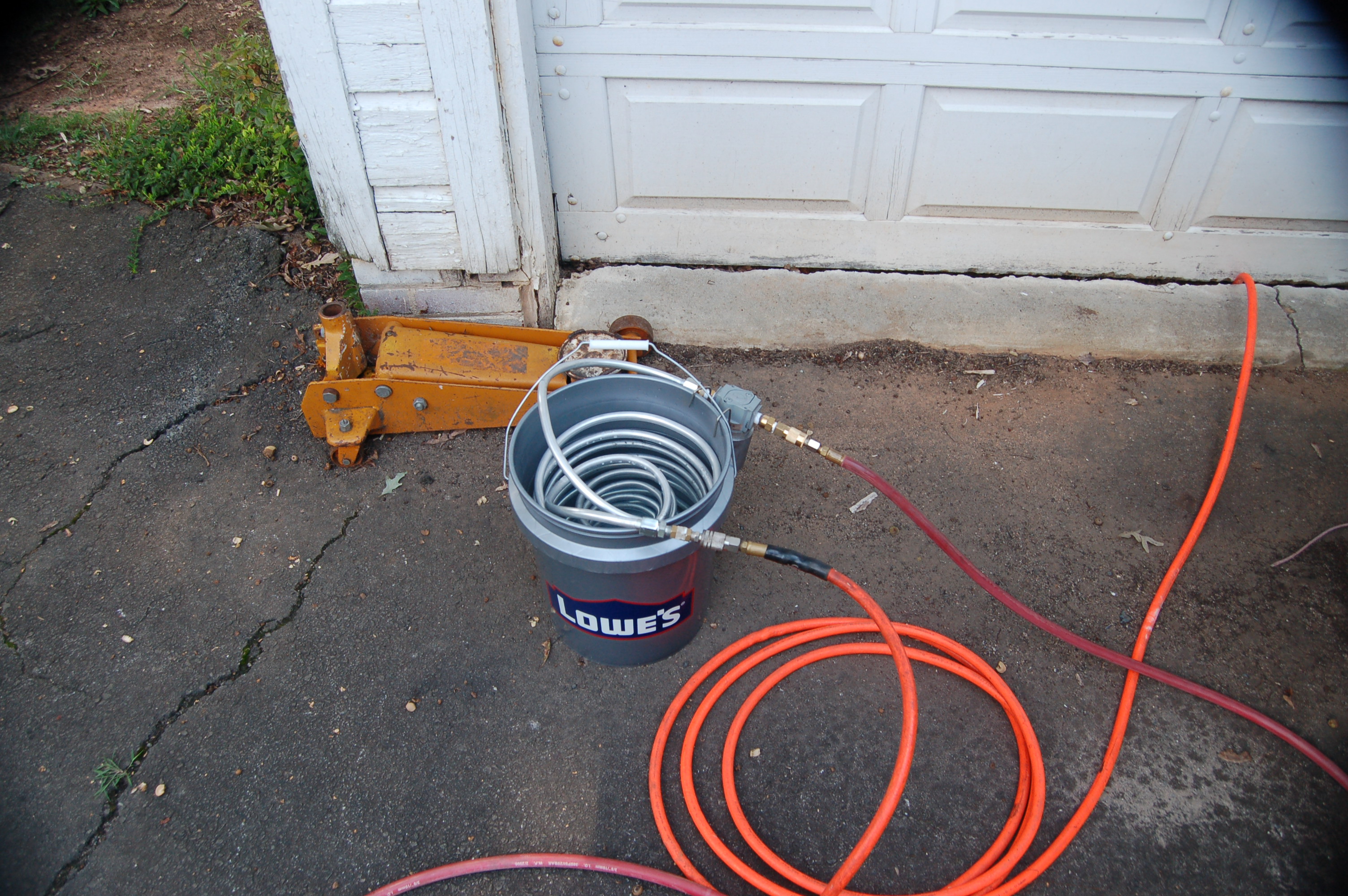

Heres my air drier I made on the cheap and it seemed to work too! Its just coiled alum tubing in ice water then to a cheapy water separator. And the before pic of the engine compartment.
