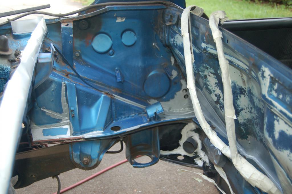

A few more before pics

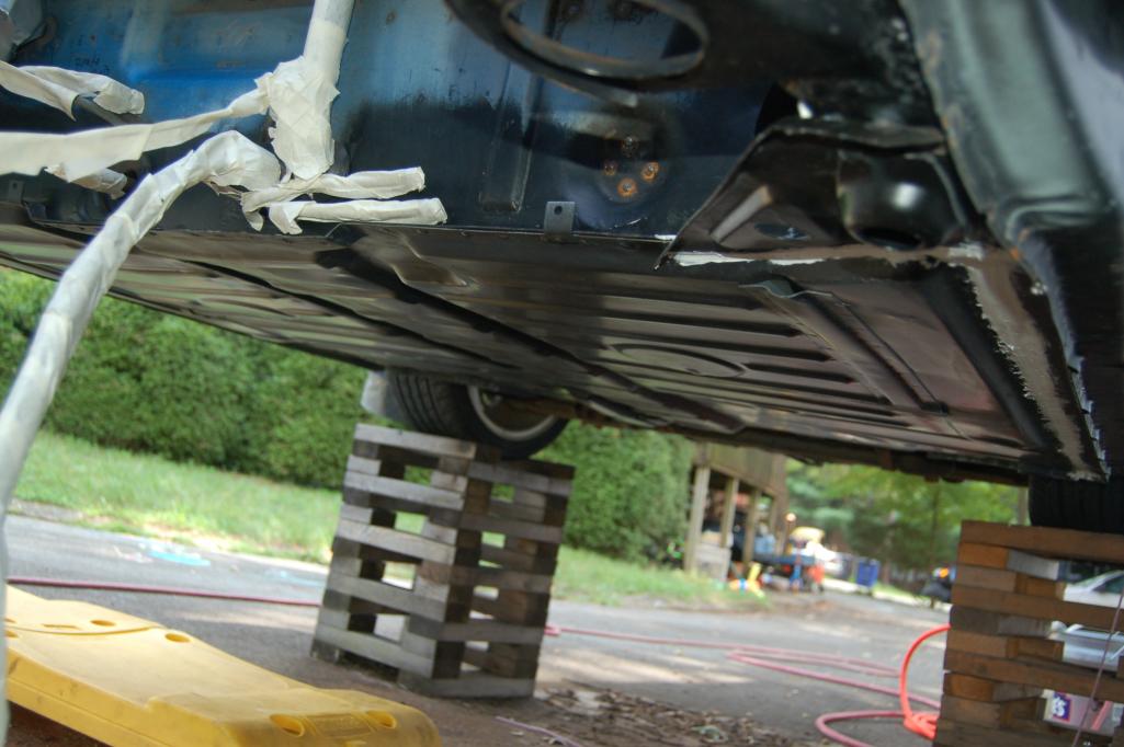

metalmorphosis   Check out my "jackstands"   Jul 31 2012, 09:15 PM
scotty b   That's trouble just waiting to happen. Nice kn...   Jul 31 2012, 09:45 PM

JawjaPorsche   When you said RUSTY build thread, you were not kid...   Aug 1 2012, 06:07 AM
mepstein   Please add me to your life insurance. $...   Aug 1 2012, 06:08 AM
arkitect   Looks like you have it braced thru the doors and a...   Aug 1 2012, 08:08 AM

metalmorphosis   Hey guys I appreciate all of y'alls concern ab...   Aug 1 2012, 11:12 AM

metalmorphosis   more k-rust   Aug 1 2012, 08:24 PM
metalmorphosis   So I think I've posted enough doom and gloom r...   Aug 1 2012, 08:55 PM
metalmorphosis   Ok 2 more the btm of the firewall and a sneak peek...   Aug 1 2012, 09:05 PM
