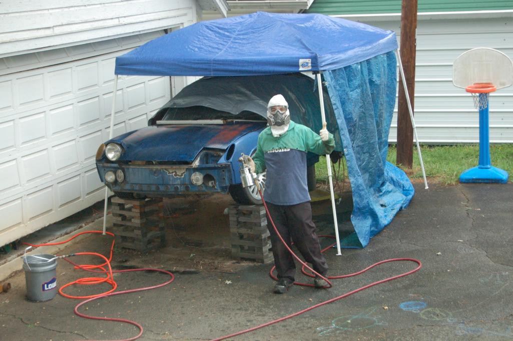

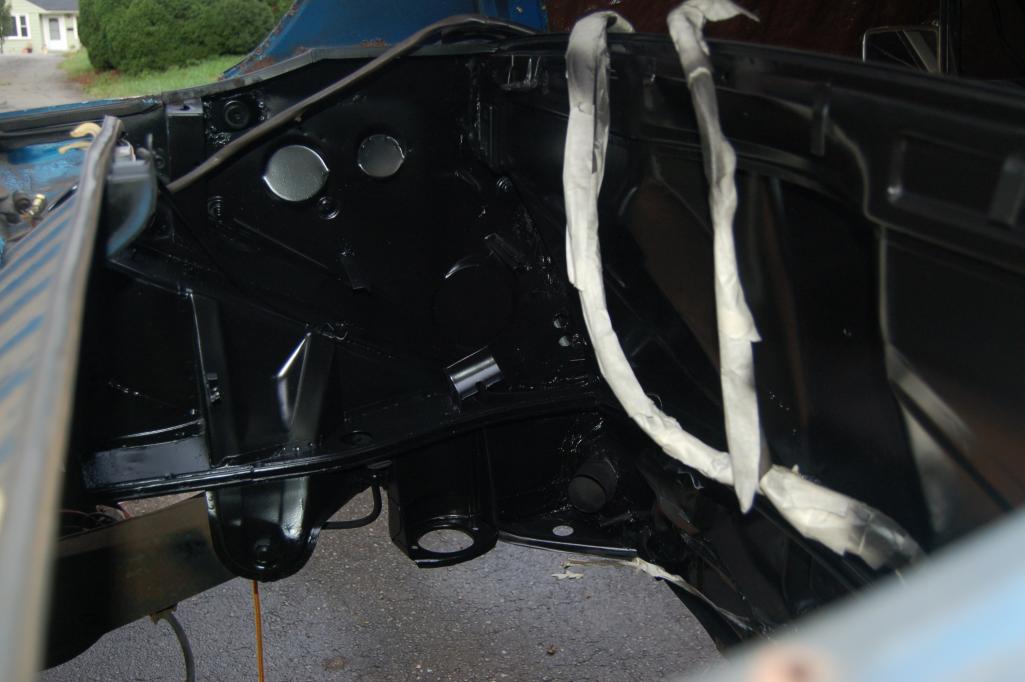

Here I am in my crazy painting get up. It started raining as soon as I finished the first coat but that wasn't stopping me! And heres the engine compartment after painting.

metalmorphosis   Well I had hoped to paint my engine compartment an...   Aug 5 2012, 07:19 PM

metalmorphosis   Here I am in my crazy painting get up. It started ...   Sep 7 2012, 09:33 PM
