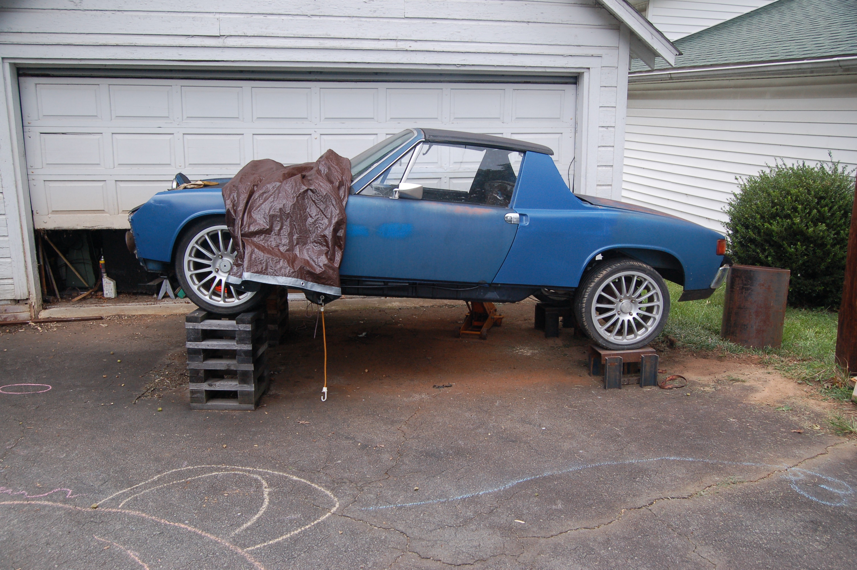

Hello 914 world! Ive been lazily lurking here for way too long and finally decided
to change that tonight. So heres my 1st contribution to all this 914 awesomeness.
This is my 914 back in 2010 when I started the rust repair. I'm almost done with
rust repair now and I have lots of pics but I have to resize and post latter. It seems like these pics are gonna work even though they are big so I guess we'll see what happens.

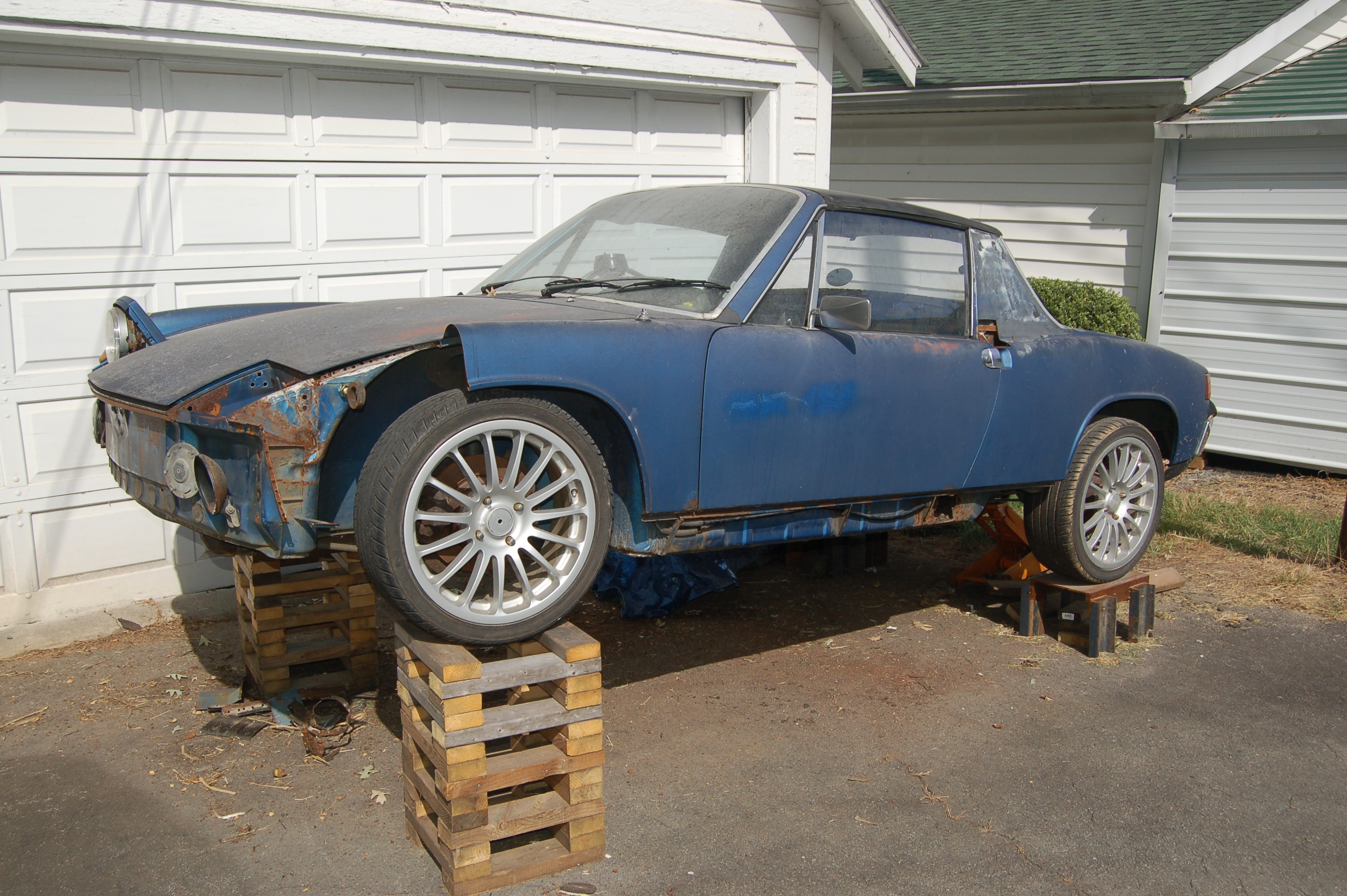

So weekend before last it was time to take it off the "jackstands"! Doug offered to help me with getting it down and I would like to say thanks again for the help! The first pic is from aprox 2 yrs ago when it was going up and the second is from 2 wks ago when it came down. I still can hardly believe its not in the air anymore!!!!
