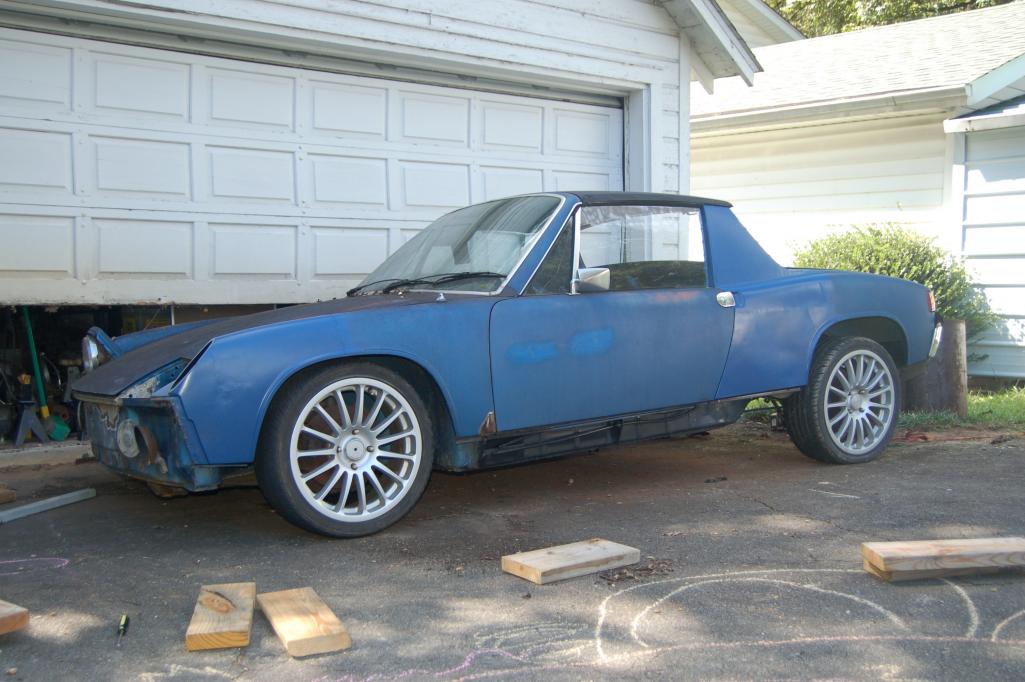

Hello 914 world! Ive been lazily lurking here for way too long and finally decided
to change that tonight. So heres my 1st contribution to all this 914 awesomeness.
This is my 914 back in 2010 when I started the rust repair. I'm almost done with
rust repair now and I have lots of pics but I have to resize and post latter. It seems like these pics are gonna work even though they are big so I guess we'll see what happens.

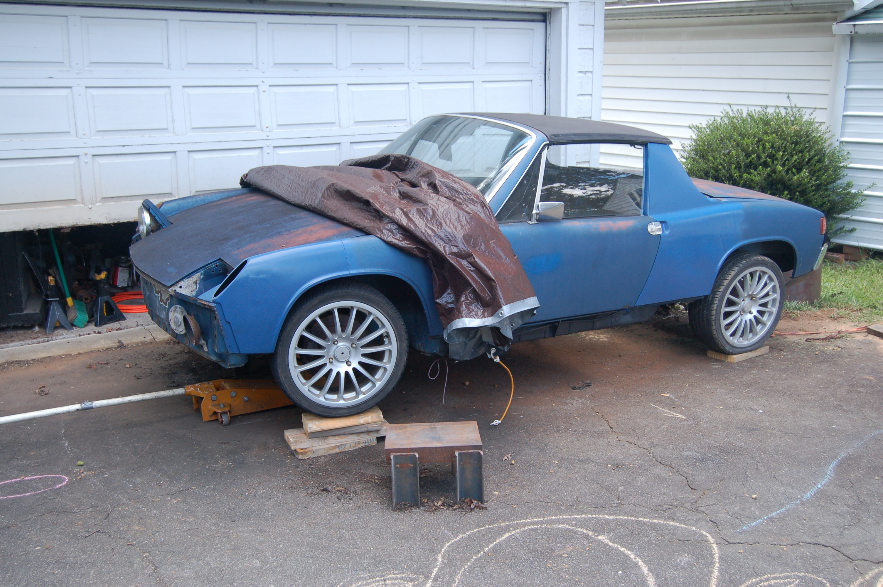

metalmorphosis   Heres a few more from 2010. Kind of k-rusty. Hey D...   Jul 31 2012, 09:11 PM
metalmorphosis   Check out my "jackstands"   Jul 31 2012, 09:15 PM
scotty b   That's trouble just waiting to happen. Nice kn...   Jul 31 2012, 09:45 PM
billh1963   Wow! That's quite a project :D It"s...   Aug 1 2012, 04:41 AM
Porschef   Stylin' rims...what are they? Nice project; i...   Aug 1 2012, 06:00 AM
JawjaPorsche   When you said RUSTY build thread, you were not kid...   Aug 1 2012, 06:07 AM
mepstein   Please add me to your life insurance. $...   Aug 1 2012, 06:08 AM
arkitect   Looks like you have it braced thru the doors and a...   Aug 1 2012, 08:08 AM
Spoke   Good luck with the rustoration. As others said, g...   Aug 1 2012, 10:11 AM
metalmorphosis   Hey guys I appreciate all of y'alls concern ab...   Aug 1 2012, 11:12 AM
fasthonda   Rust wise that car really isn't too bad imo. N...   Aug 1 2012, 07:25 PM
metalmorphosis   Hey Michael I just use a drill I do own a spot wel...   Aug 1 2012, 08:21 PM
