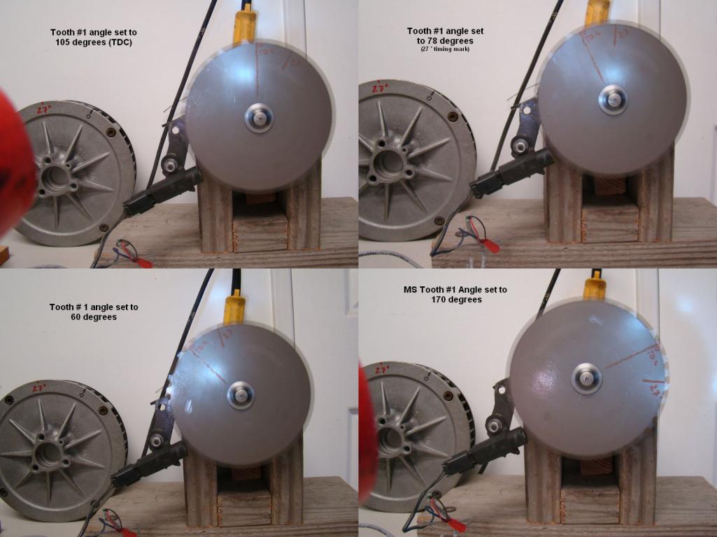

Yes, I confirmed tonight that the Tooth #1 angle adjustment is VERY flexible. I took some photos of the timing wheel (that I marked up with TDC roughly same spot as Mark's wheel) with my test setup. I fee comfortable with this now (IMG:style_emoticons/default/smile.gif)
Also, ordered up some SS fuel lines+tank screen from Tangerine Racing, so looks like I will be diving into the car soon. Wonder if I really need to remove the tank (IMG:style_emoticons/default/barf.gif)
I need to mount my fuel pump under the tank too. Any tips on doing this?

Michelj13   Can anyone comment on my settings? I put them all ...   Sep 4 2012, 11:49 PM
McMark   IIRC, the Tooth #1 Angle (top right box in your im...   Sep 5 2012, 11:37 AM
Michelj13   I am deleting this post, because information was n...   Sep 5 2012, 10:17 PM
aircooledtechguy   I will need to make another bench experiment, but...   Sep 6 2012, 10:22 AM
McMark   IMHO, timing should always be confirmed via timing...   Sep 6 2012, 11:57 AM
aircooledtechguy   IMHO, timing should always be confirmed via timin...   Sep 6 2012, 04:25 PM
Michelj13   Yes, I confirmed tonight that the Tooth #1 angle a...   Sep 6 2012, 11:57 PM
