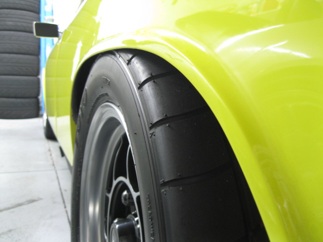

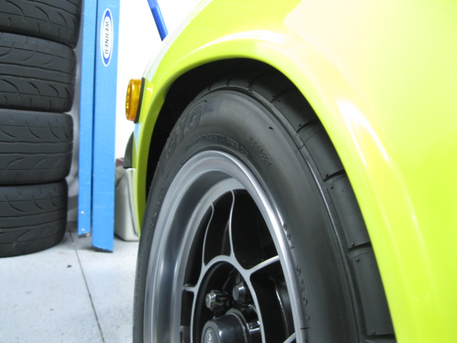

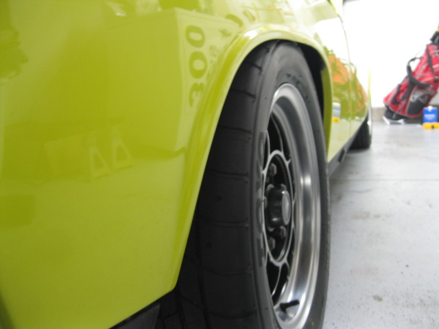

Here's a coupe of shots of the 15x7s on my car. Veeerrry tight with a 225/50-15 on the back, with a moderate fender pull and rolled lip. Car is not aligned yet, but a quick jackstand/string alignment shows the left rear is near zero toe (where I want it) and right rear is slightly toed out...but there's more space to work with, so it all should work out. Had to go with the 225...love the look, and I need to hook up my LS1 horsepower! (IMG:style_emoticons/default/piratenanner.gif)
Left rear has a very light rub/squeak when hitting a big bump...very livable. I bet 205s would work easily here, maybe without a pull.
Plenty of room up front; tires here are 205/50-15. My car has 911 struts/hubs/brakes, so I'm not sure how lateral spacing compares with stock 914.
