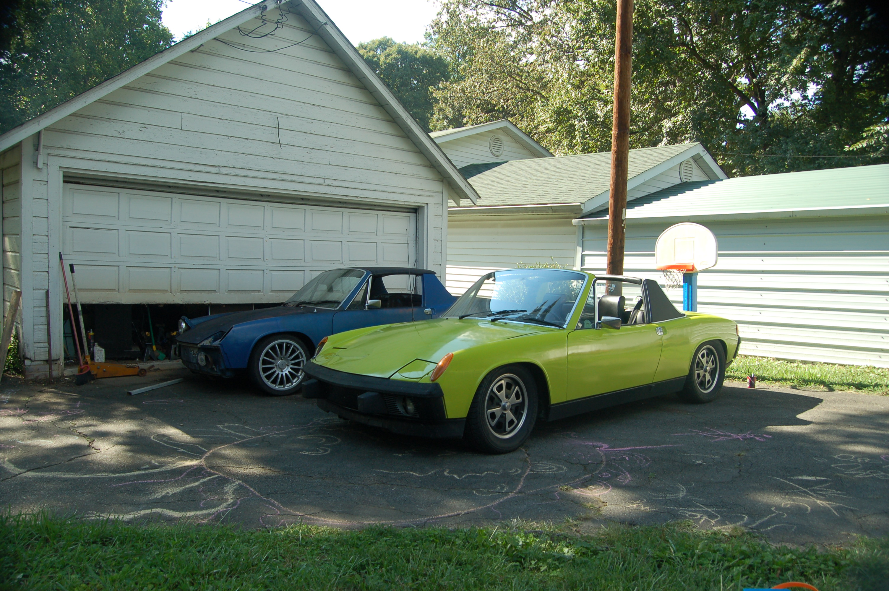

metalmorphosis   I DROVE MY CAR TONIGHT!!!!!...   Dec 8 2012, 08:27 PM
