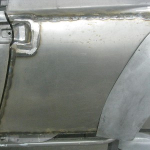

Hi, i'm currently converting this 914 to a GT for a customer and thought i'd post the metal work progress as i go along.
Thanks for looking !
(IMG:http://www.914world.com/bbs2/uploads_offsite/www.themetalsurgeon.com-14902-1347170740.1.jpg)
(IMG:http://www.914world.com/bbs2/uploads_offsite/www.themetalsurgeon.com-14902-1347170740.2.jpg)
(IMG:http://www.914world.com/bbs2/uploads_offsite/www.themetalsurgeon.com-14902-1347170740.3.jpg)

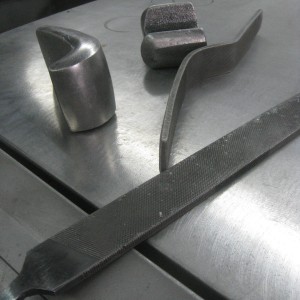

if you have time - pls post pics of the tools - and tools in action - if you have time

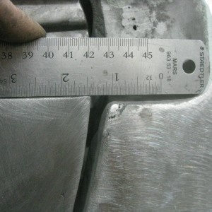

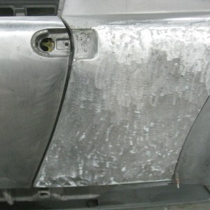

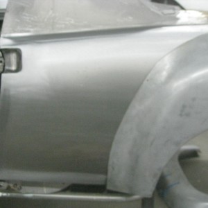

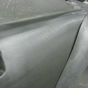

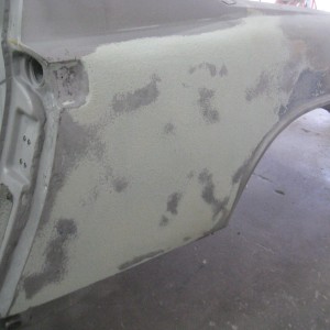

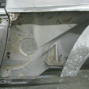

The rear LH side had been in an accident in the past taking damage to the front fender,door and rear quarter.Before we graft the flare in, the door was metal finished and the front section of the rear quarter panel replaced with freshly made metal along with the door handle depression fixed and grafted into the new quarter.
(IMG:http://www.914world.com/bbs2/uploads_offsite/www.themetalsurgeon.com-14902-1347212558.1.jpg)
(IMG:http://www.914world.com/bbs2/uploads_offsite/www.themetalsurgeon.com-14902-1347211395.1.jpg)
(IMG:http://www.914world.com/bbs2/uploads_offsite/www.themetalsurgeon.com-14902-1347211395.2.jpg)
(IMG:http://www.914world.com/bbs2/uploads_offsite/www.themetalsurgeon.com-14902-1347211395.3.jpg)
(IMG:http://www.914world.com/bbs2/uploads_offsite/www.themetalsurgeon.com-14902-1347211395.4.jpg)
(IMG:http://www.914world.com/bbs2/uploads_offsite/www.themetalsurgeon.com-14902-1347211395.5.jpg)
(IMG:http://www.914world.com/bbs2/uploads_offsite/www.themetalsurgeon.com-14902-1347211396.6.jpg)
(IMG:http://www.914world.com/bbs2/uploads_offsite/www.themetalsurgeon.com-14902-1347211396.7.jpg)
(IMG:http://www.914world.com/bbs2/uploads_offsite/www.themetalsurgeon.com-14902-1347211396.8.jpg)

The Metal Surgeon   The rear LH side had been in an accident in the pa...   Sep 9 2012, 11:23 AM

rdauenhauer   I presume that is all TIG welding?   Sep 9 2012, 06:13 PM
scotty b   I presume that is all TIG welding? I would gues...   Sep 9 2012, 06:29 PM
The Metal Surgeon   rdauenhauer your right TIG welding.   Sep 9 2012, 07:45 PM

bulitt   Wow. Are you lead-ing over the welds? So how many...   Sep 10 2012, 03:57 AM
The Metal Surgeon   No lead over the welds ,just bare metal. I...   Sep 10 2012, 08:51 AM
