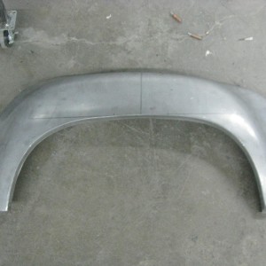

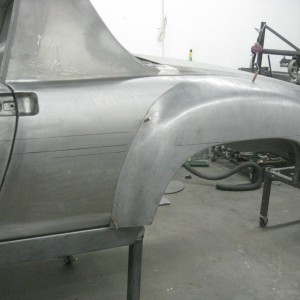

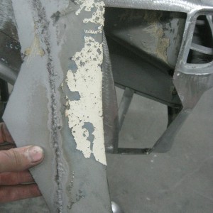

Hi, i'm currently converting this 914 to a GT for a customer and thought i'd post the metal work progress as i go along.
Thanks for looking !
(IMG:http://www.914world.com/bbs2/uploads_offsite/www.themetalsurgeon.com-14902-1347170740.1.jpg)
(IMG:http://www.914world.com/bbs2/uploads_offsite/www.themetalsurgeon.com-14902-1347170740.2.jpg)
(IMG:http://www.914world.com/bbs2/uploads_offsite/www.themetalsurgeon.com-14902-1347170740.3.jpg)

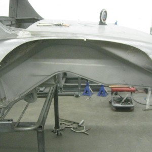

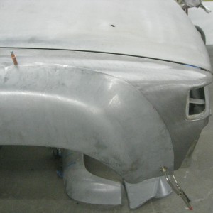

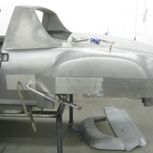

(IMG:http://www.914world.com/bbs2/uploads_offsite/www.themetalsurgeon.com-14902-1347212860.1.jpg)
(IMG:http://www.914world.com/bbs2/uploads_offsite/www.themetalsurgeon.com-14902-1347212860.2.jpg)
(IMG:http://www.914world.com/bbs2/uploads_offsite/www.themetalsurgeon.com-14902-1347212860.3.jpg)
(IMG:http://www.914world.com/bbs2/uploads_offsite/www.themetalsurgeon.com-14902-1347212861.4.jpg)
(IMG:http://www.914world.com/bbs2/uploads_offsite/www.themetalsurgeon.com-14902-1347212861.5.jpg)
(IMG:http://www.914world.com/bbs2/uploads_offsite/www.themetalsurgeon.com-14902-1347212861.6.jpg)

The Metal Surgeon   The rear LH side had been in an accident in the pa...   Sep 9 2012, 11:23 AM
The Metal Surgeon   http://www.914world.com/bbs2/uploads_offsite/www.t...   Sep 9 2012, 11:47 AM
