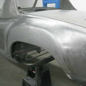

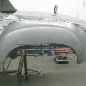

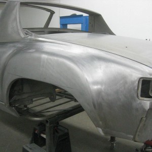

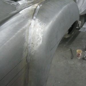

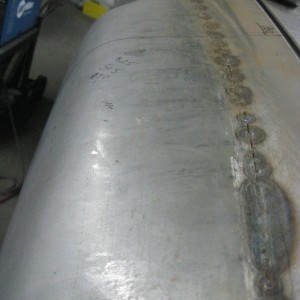

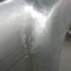

Hi, i'm currently converting this 914 to a GT for a customer and thought i'd post the metal work progress as i go along.
Thanks for looking !
(IMG:http://www.914world.com/bbs2/uploads_offsite/www.themetalsurgeon.com-14902-1347170740.1.jpg)
(IMG:http://www.914world.com/bbs2/uploads_offsite/www.themetalsurgeon.com-14902-1347170740.2.jpg)
(IMG:http://www.914world.com/bbs2/uploads_offsite/www.themetalsurgeon.com-14902-1347170740.3.jpg)

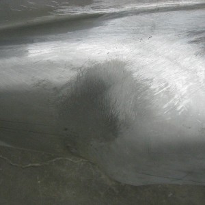

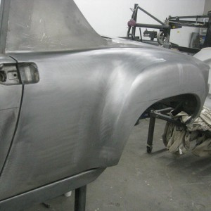

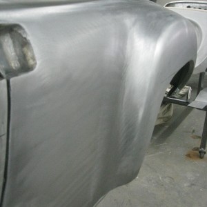

Thanks for the welcome and checking out the thread.
(IMG:http://www.914world.com/bbs2/uploads_offsite/www.themetalsurgeon.com-14902-1347217390.1.jpg)
(IMG:http://www.914world.com/bbs2/uploads_offsite/www.themetalsurgeon.com-14902-1347217390.2.jpg)
(IMG:http://www.914world.com/bbs2/uploads_offsite/www.themetalsurgeon.com-14902-1347217390.3.jpg)
(IMG:http://www.914world.com/bbs2/uploads_offsite/www.themetalsurgeon.com-14902-1347217391.4.jpg)
(IMG:http://www.914world.com/bbs2/uploads_offsite/www.themetalsurgeon.com-14902-1347217391.5.jpg)
(IMG:http://www.914world.com/bbs2/uploads_offsite/www.themetalsurgeon.com-14902-1347217391.6.jpg)
(IMG:http://www.914world.com/bbs2/uploads_offsite/www.themetalsurgeon.com-14902-1347217391.7.jpg)
(IMG:http://www.914world.com/bbs2/uploads_offsite/www.themetalsurgeon.com-14902-1347217391.8.jpg)
(IMG:http://www.914world.com/bbs2/uploads_offsite/www.themetalsurgeon.com-14902-1347217391.9.jpg)

rdauenhauer   I presume that is all TIG welding?   Sep 9 2012, 06:13 PM
scotty b   I presume that is all TIG welding? I would gues...   Sep 9 2012, 06:29 PM
The Metal Surgeon   rdauenhauer your right TIG welding.   Sep 9 2012, 07:45 PM

bulitt   Wow. Are you lead-ing over the welds? So how many...   Sep 10 2012, 03:57 AM
The Metal Surgeon   No lead over the welds ,just bare metal. I...   Sep 10 2012, 08:51 AM
