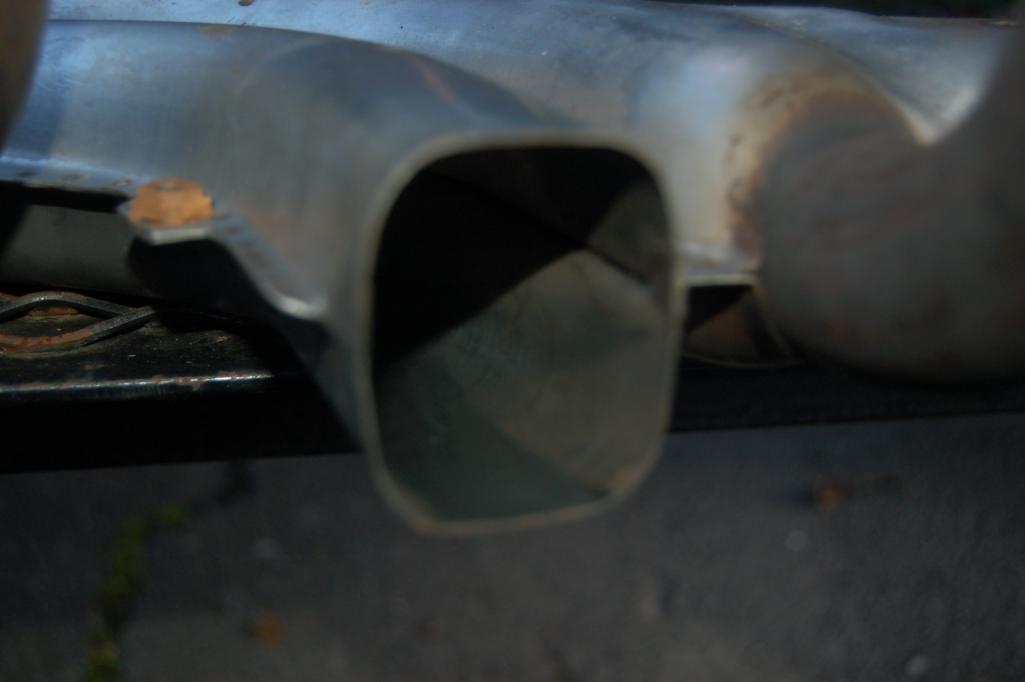

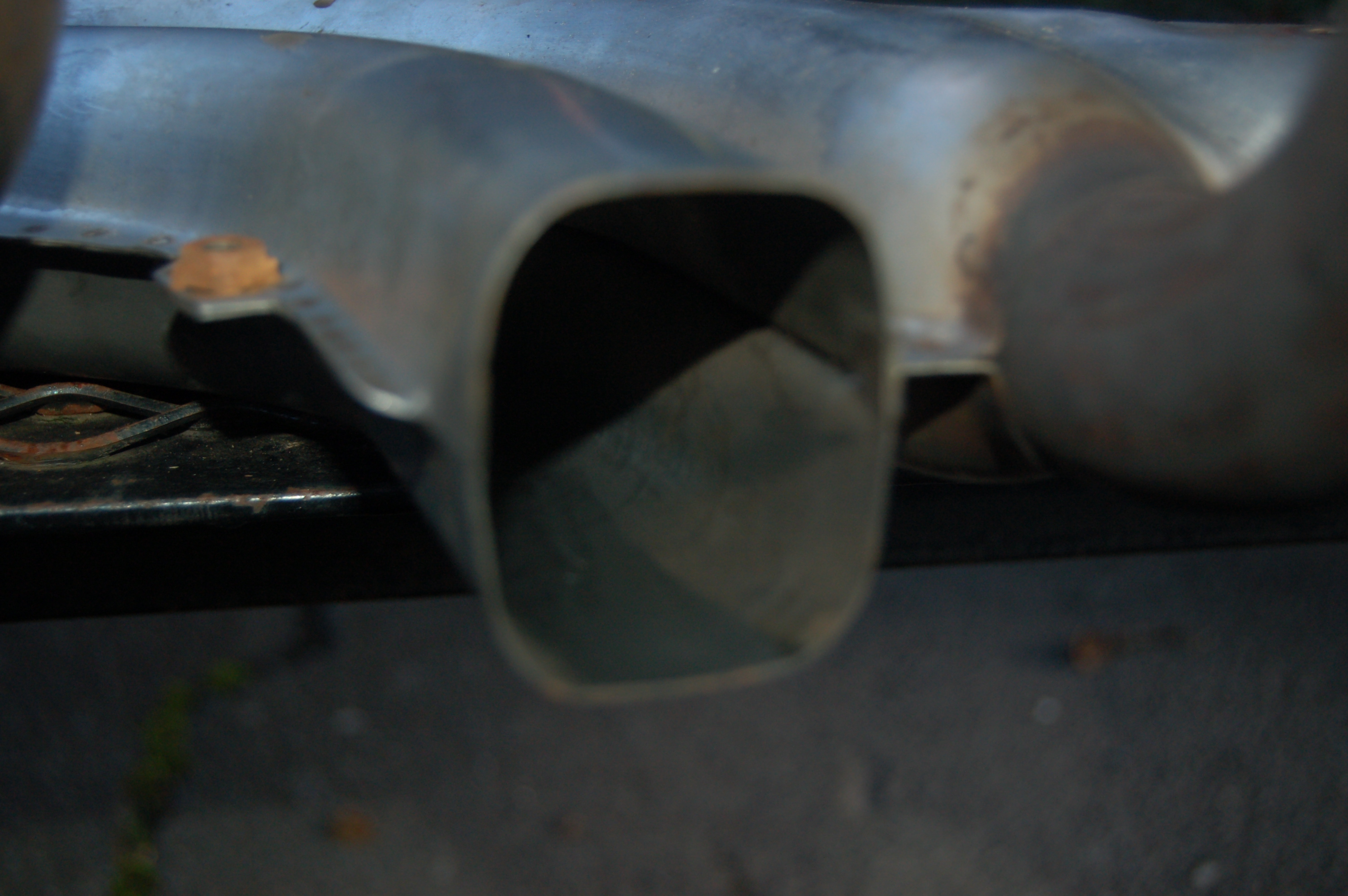

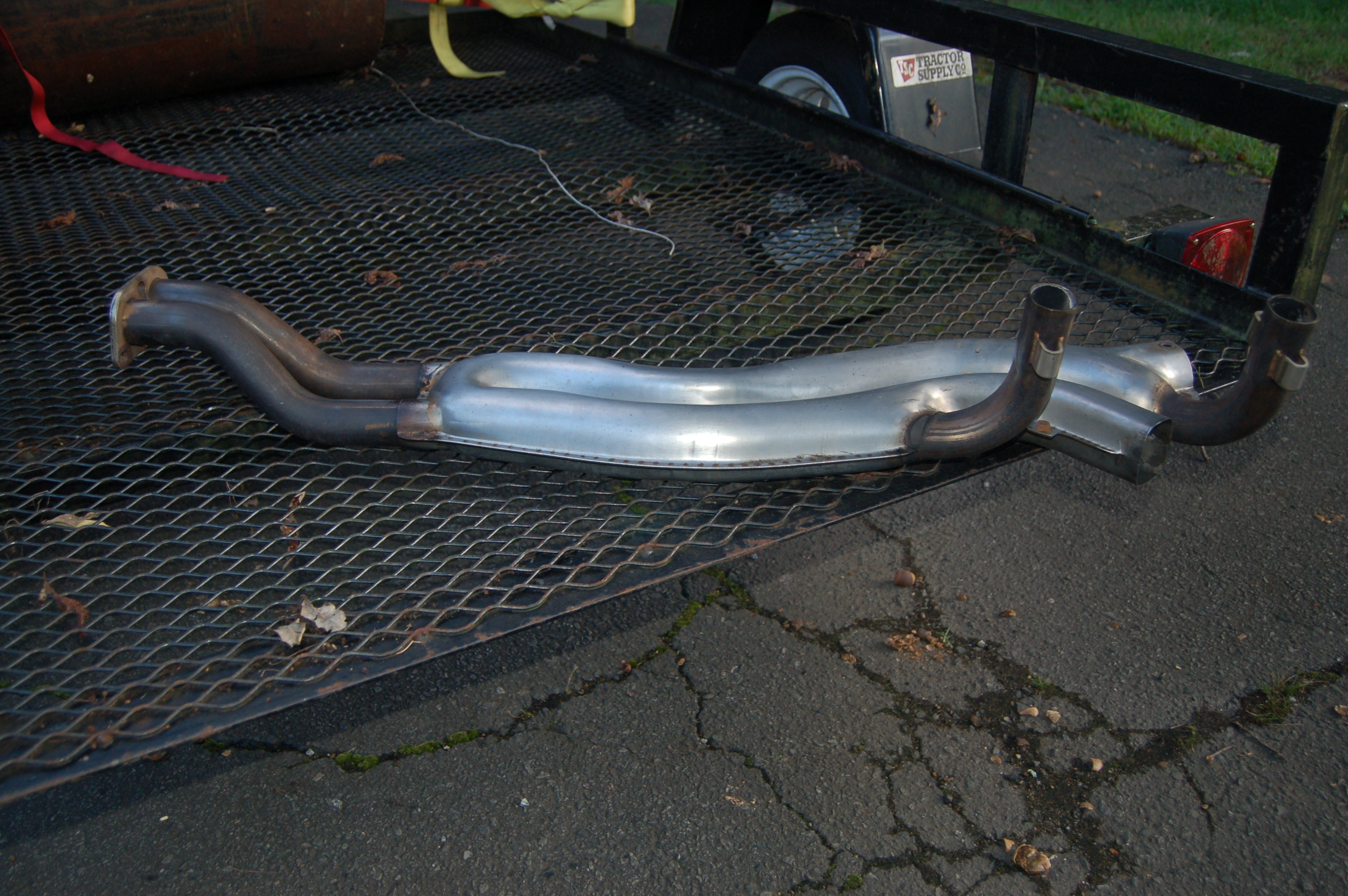

Hey Pete W-S is about to have another one back on the road, so yea get to work on the car that matters! Anyway I cleaned my stainless heat exchangers the other day and they were still grimmy on the inside. I want my heat to smell as non oily as possible so off to the radiator shop they went. The insides look great and didn't cost an arm and a leg. The 2nd pic is a little blurry but you get the idea.
