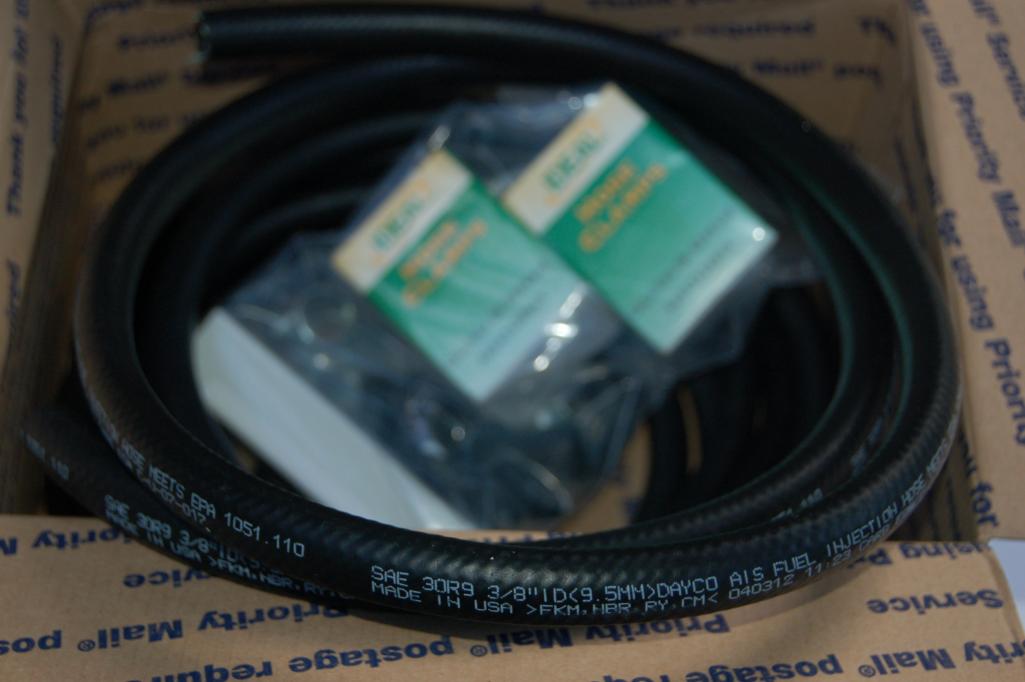

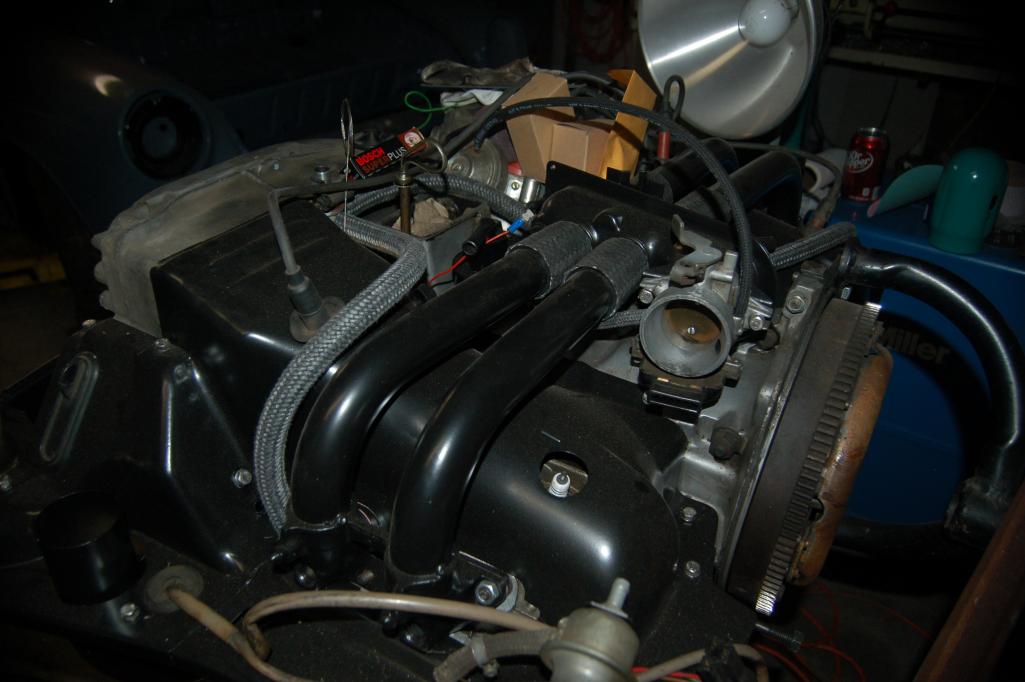

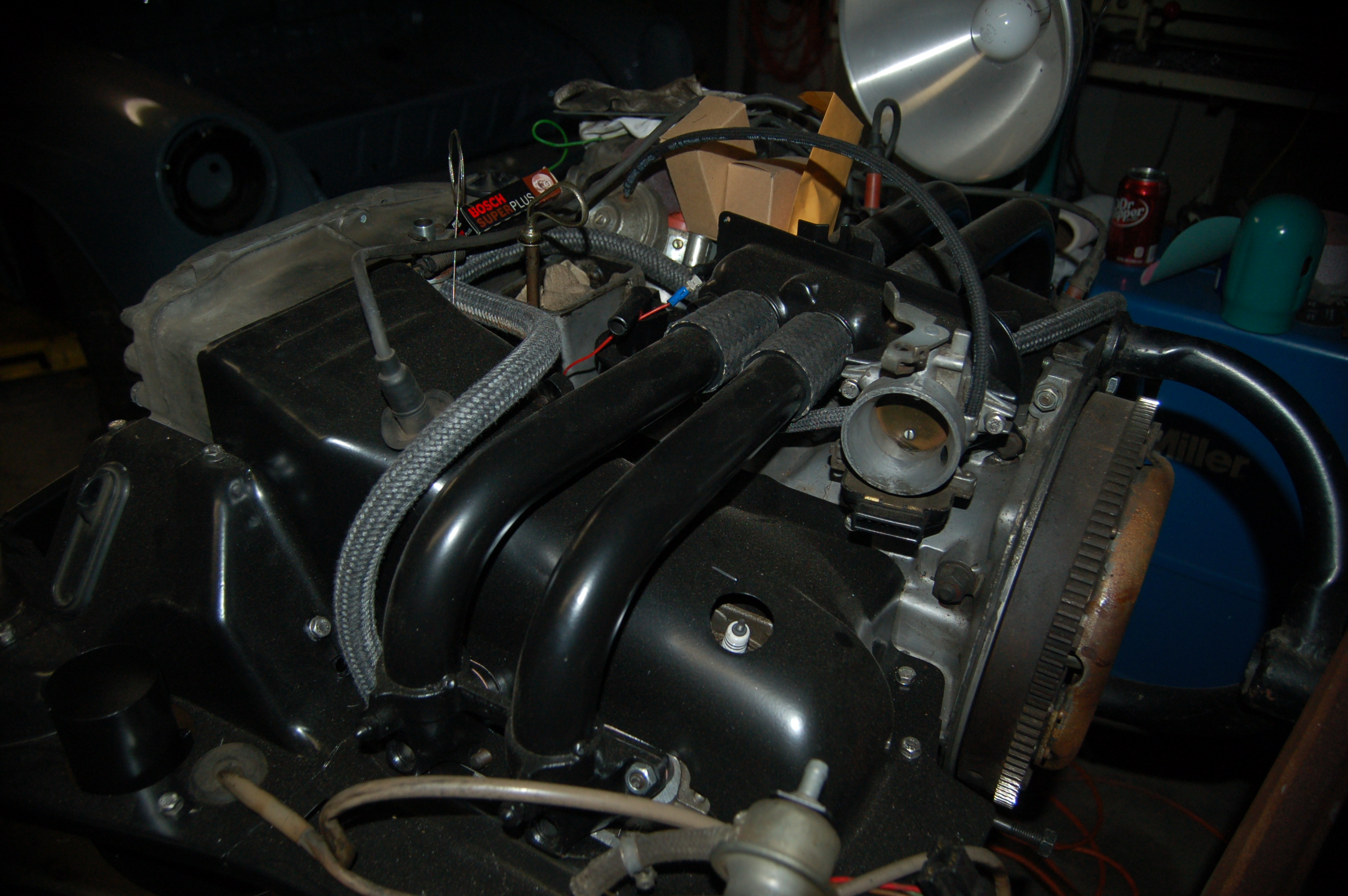

Also got my new 30r9 fuel lines from Tangerine racing today. Thanks Chris! Also throwin in a pic on the engine.
