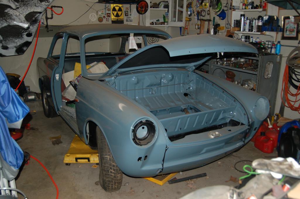

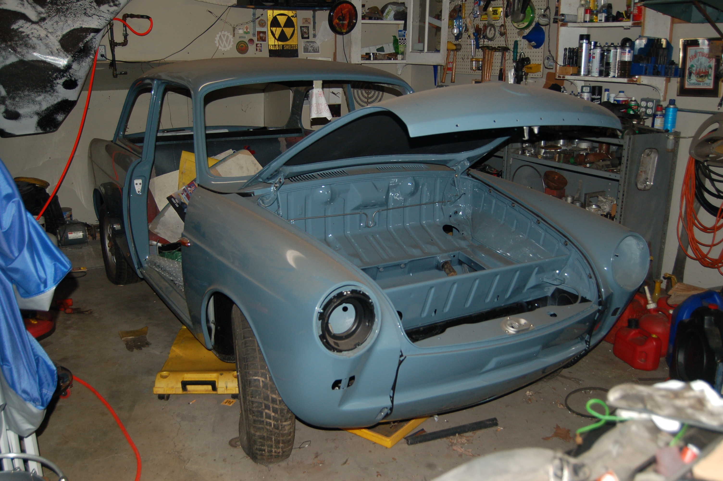

metalmorphosis   Last one for tonight, heres whats next when the 91...   Sep 10 2012, 06:25 PM
